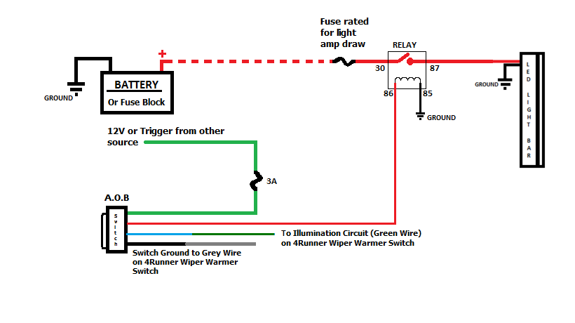

There should be a wiring diagram that comes with the AOB switch. But... the Green and Grey wires are only for the illumination/courtesy circuit; NOTHING ELSE! Under no circumstances are these wires able to operate the fog-lights or the harness relay; this circuit is for the instrument cluster lighting (this is the power supply from the parking light circuit to illuminate the dash switches at night) on the dash!
I don't know where to hook up my
AOB red or my AOB green
I have an AOB wiring schematic in one of my threads but I can't remember which one at the moment, so use the search function at the top of the GEN-5 forum; just put in AOB switch wiring diagram and plenty should come up.

In the Harness kit, it looks like the small (16ga) RED wire goes from the battery power source under the hood to the switch (HOT). The small black wire (16ga) comes from the ground under the hood and goes to the switch; that's only for the ON/OFF indicator. And the yellow appears to trigger the relay from the switch in the LED cabin (ARB harness). NOTE: The Green and Gray wires that you mentioned in your last post appear to be from the courtesy light circuit to illuminate all of the dash switches... The large (RED & BLK 8ga/4ga) cables are to be connected directed to the POS and NEG battery posts and should have an in-line fuse holder built-in to protect the wiring in the harness. The ARB kit should come with a wiring schematic(?) ...or again; do a search at the top of this page, 'Best to you',
rig
Will this help?
[MENTION=83083]rigtec[/MENTION] covered everything else....
Don't laugh when I tell you this but I guess I just don't quite understand how I would tap into the grey and green wire. It seems like there should be a Y fitting that I could use but I know that's not the case. So would I just cut a wire, then shove the old cut wire and the new wire into a butt connector?
[MENTION=103267]Saker[/MENTION] thanks for the diagram and making it more scenario specific. I'm a little confused on where AOB GREEN goes.
I also went and looked at my relay. I had no idea that those things were numbered. So that makes things easier to understand but I still have some questions
I know it says 12v power source but not sure where that would be.
I also see that you want me to connect to 86 on the relay. The AOB diagram says that's for older vehicles and for newer vehicles I should use 85 on the relay. Please be patient with me. I just don't quite see what difference would be if there even would be one.

Question for you, picture doesn't show connection of black wire at relay, but looks to me like the light bar ground wire and small black wire are connected to terminal 86 on relay, does it also have an addition black wire that connects to a ground source in engine compartment?
If the above is true, then your switch harness (small black, yellow, red wires) would be............
Red - All time power 12v.
Yellow - Trigger to relay, applying 12v will energize relay turning on light bar
Black - Ground, not used with AOB switch
You have two choices on how you want light bar to turn on;
1) Turn on whether ignition is on/off (all time power), connect red wire to AOB red. Add 3 amp fuse to protect AOB switch.
2) Ignition only, connect AOB red to and ignition source such as cigarette lighter or ignition source at fuse panel. Red harness wire not used, cap wire off to prevent any chance of shorting.
Yellow wire connects to AOB green wire (12v output when switch is turned on).
Hope that helps & good luck!
Terminal 86 has one bigger black wire going to the light bar and one bigger black wire going to the battery and one little black wire going to nothing.
I just looked at your harnesses wiring. The large RED wire connects to the pos battery terminal and relay term #30. The Large BLK wire runs between terminal #87 (N/O) normally opened contacts and the load (LED's lighting), which will feed your lights when the switch is on. The small red wire is HOT and feeds the AOB switch at the #86 terminal (Coil). And the small BLK wire will provide the ground to #85 terminal(Coil)! That's it!

If you do not want to tap into any of your factory wirings for the switch, here is what I did. Here what I did for the switch.
The green goes to my battery for the power source. This allows me to turn on the lights with the engine off. You can tap a fuse if you only want the switches to work when the car is turned on.
The blue was a fuse-tap to the taillights. This will illuminate the switch when you turn on your lights. Note: doing it this way, you CANNOT dim the switches. This would be the green factory wire on the wiper warmer switch.
The red connects to the relay
The black was grounded to a nearby ground. This would be the grey wire on the wiper warmer switch.
