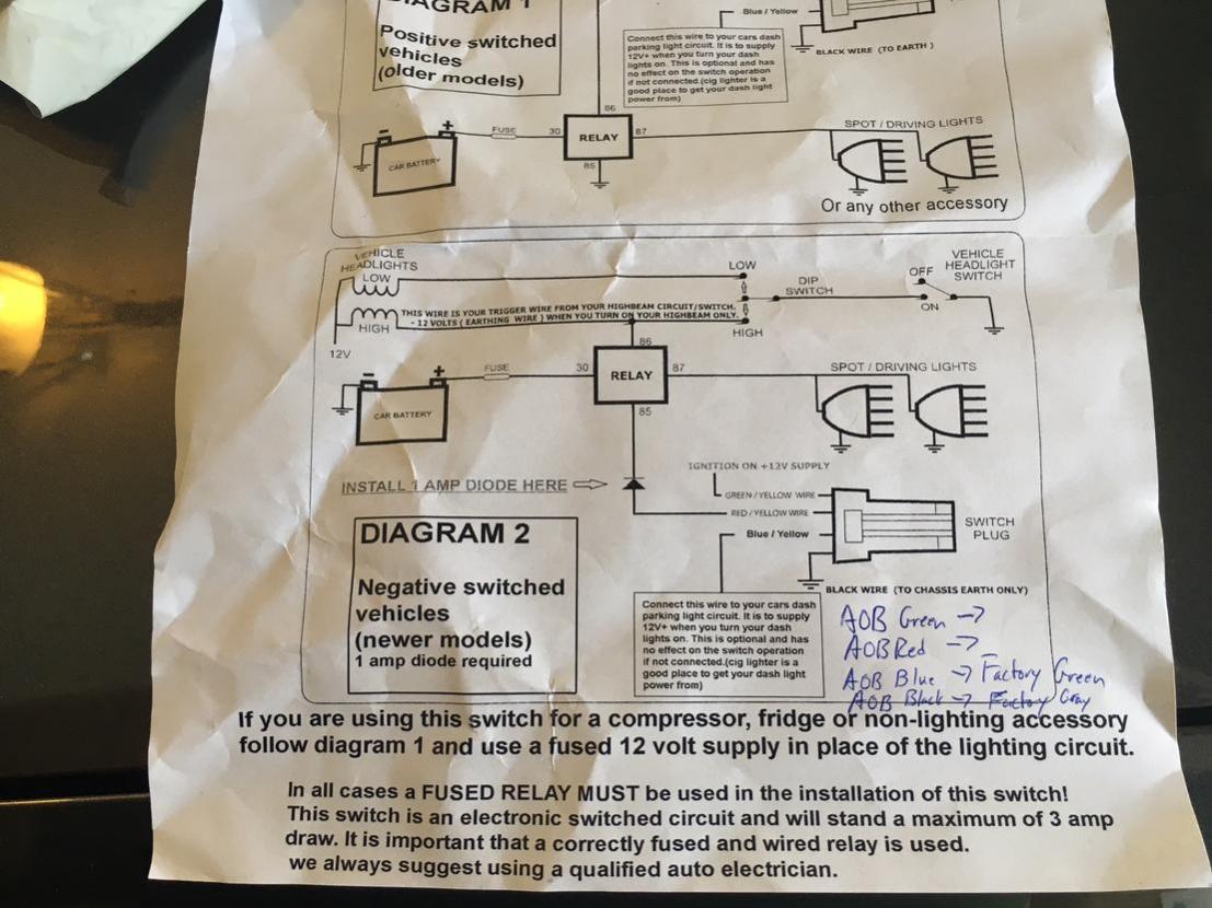

If they changed the colors I’m not sure. From the AOB instructions do they show. I’ve attached a picture of my original instructions from AOB.
Also I have the wiring of just the switch dimming portion outlined here.

Thanks a bunch rig. According to my AOB switch wiring diagram it is the green wire that is the main feed. The blue wire is only for switch illumination. The wires om my switch are red, green, black and blue. I do like the idea of tapping off the cigarette lighter but I have all working now and if I forget my 32in led light bar is on then I have other issues. At some point maybe I will switch it. Thank you for the great information. Very much appreciated,
Primo
[MENTION=83083]rigtec[/MENTION] coming through in the clutch. Thanks for the detailed explanation!
:bravo: :trophy:
Primo
Hey Primo,
I just saw that and was writting about the difference between the two Identical series diagrams; mine may be posted somewhere on forum... trouble is, Photo Bucket is now using a large WATER MARK on all images that were processed/converted there... and I'm NOT spending any $$$,00 to feed their greedy pockets, lol!
The copy that I have here is as you replied, is different than the one already posted by [MENTION=120701]Cymon[/MENTION] , so just go with his for now, and if you have any trouble, then go with the wire colors as I described; it's gotta be one or the other; just not sure (Now) which one is correct! ...but thanks for the "Heads-up"!
