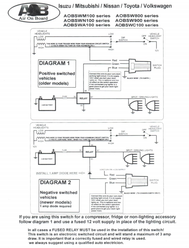

diagram is inconsistent with eBay switch vendor
[MENTION=147757]GearJunkie88[/MENTION]
Dug this up. I think Engineer is spot on with the diode as most new vehicles use diagram 2
This is just the exact opposite (RED & GREEN reversed) of the diagram I was supplied for my son's Sequoia. When I asked the eBay vendor, AOB USA for an internal wiring diagram, I got this advice quote
"we don't have one the red and green wire is for the switch turning on and off and the top light is on that circuit the blue wire is a independent light and black is ground for both lights Regards John"
I am guessing it makes no difference if it is just mechanical. OTH if a semiconductor or switching diode was used internally, then the correct color must be used for the 12 volt supply. The bottom LED is red and lights up when the switch is enabled. When pushed, the top LED lights up green. If the switch works but the LEDs do not light up then IMHO the red and green wires need to be reversed.
