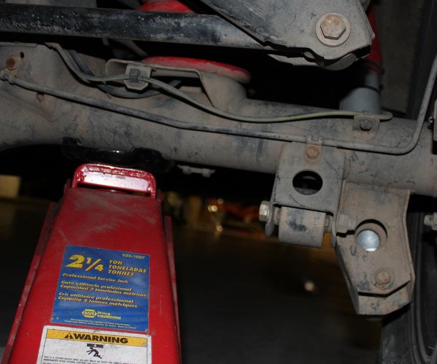

Why not jack it up from the axle?...not suspension components.
That point shown is not exactly the thickest metal and there is a rubber bushing in the end of that trailing arm.
This is how I do it.

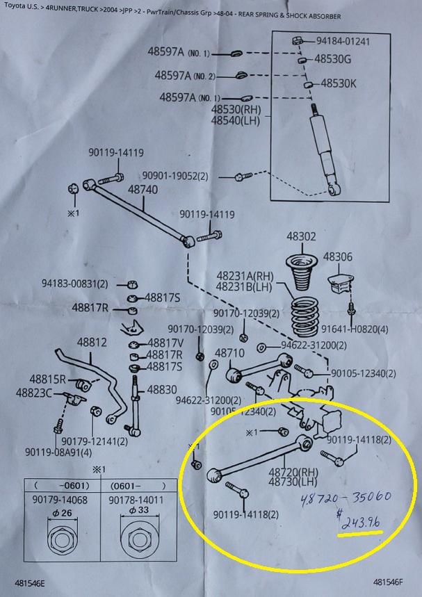

That's a $243.96 OEM part that your using for a jacking point.
Not saying you cant jack your 5000lbs runner from the lower rear trailing arm...I wont. I forget that common sense is not in abundance these days.
This is from local Toyota Dealer back in July.

i always use the bottom of the rear axle pumpkin, the lower the part, the higher i can jack the truck up.
