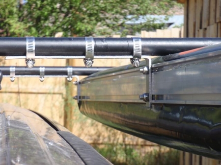

Can I mount ARB awning on OEM roof Racks? If this topic has been discussed before, please point me in the right direction. I read somewhere that CVT sells hadware/mounting brackets that should work with OEM roof rack.
Thanks
The CVT awning comes with "L" brackets for mounting. I have one mounted to Yakima bars using 3 hose clamps per "L" bracket. I will try to get a picture for you later this evening or maybe try googling it... i know there is a picture somewhere of this setup. And i think that these "L" brackets could work with an oem rack. Just my .02 though.
This is the image i am talking about.
