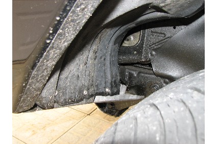

Here's my solution to both. Was planning on posting these at some point might as well be here! Covered both sides underneath & gave a place to attach inner fender liner.

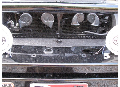

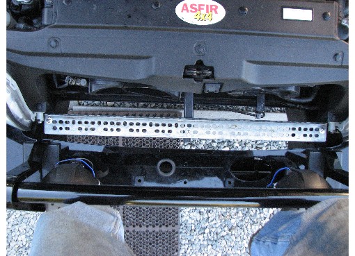

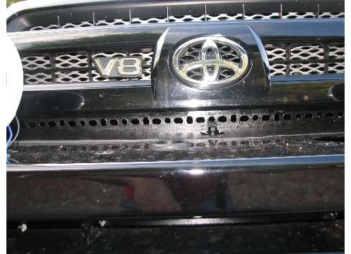

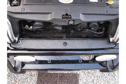

....And my solution for the gap between the ARB & grill to provide radiator protection.
Had the galvanized angle steel hanging around but you can get similar at your local Lowe's etc. Brushed on bedliner. Attached it to the 3 factory bumper supports (had to flex the outboard ones a little to line up holes, no problem though). Painted black & bought a sheet of ABS plastic & cut to fit space between ARB & the steel. The last picture is taken with the hood closed but with a flash to see it. It's set back about 2" or so from the front of the grill so it really isn't visible. Provides mer peace of mind for foreign objects & still allows airflow.

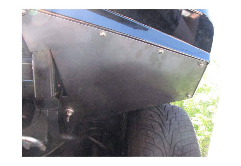

For the sheet metal underneath, I had some sheet SS hanging around. I made a template out of cardboard & used the body mount bolt (bought an extra metric nut, 2 stainless washers & a rubber grommet for the hole) to make a template. Just reversed the template for the other side. I then bent up a tab on the back to allow me to attach the cut fender liner. I did have to make an adjustment to clear the turning wheel so the back section actually has two bends at slightly different angles. If needed I can get a different picture of the back. I then drilled & tapped the underside lip of the bumper for the other 5 machine screws.

Cowanrg, for 2) that's why I did the angle iron/ABS plastic; didn't want to cut up the bumper cover.
