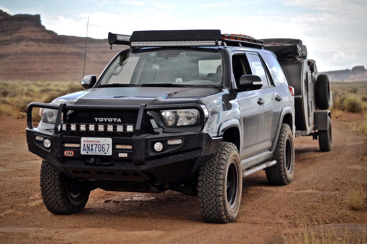

[MENTION=66300]Intruder[/MENTION] wheels the bejeezus out of his 4R and it's what originally inspired me to go the ARB way. But, I respect everyone's different tastes in mods as long as they are done properly and not hacked on.

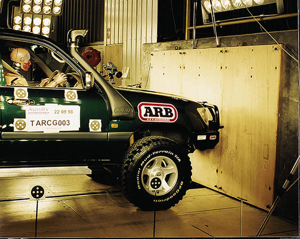

I do. I worked there for 6 years during the time they designed their airbag compatible system. All it does it is ensure that their bumper does not adversely effect the airbag deployment characteristics. The crumple zones/ripples in most of their designs were engineered to replicate some of the OEM components that are removed during installation. The single biggest variable is the vehicle mass. The heavier the vehicle, the more ripples in the mounting brackets. ARB spend considerable time ENGINEERING their products and they spend thousands of dollars doing so. When the airbag brackets were designed they crash tested a 100 series landcruiser to ensure a vehicle equipped with their bullbar met ADR (Australian Design Rules) for frontal collisions. That test validated the system. Each subsequent design is thoroughly tested using other engineering methods (FEA for example)to simulate the conditions.

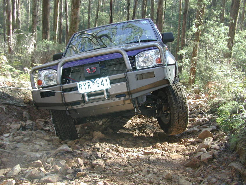

We used to do pretty severe side pulls with a winch on new products. This one almost maxed out the winch and actually rolled the tire off the rim on the one front wheel. But the bullbar hardly moved. This was a Nissan Navara.

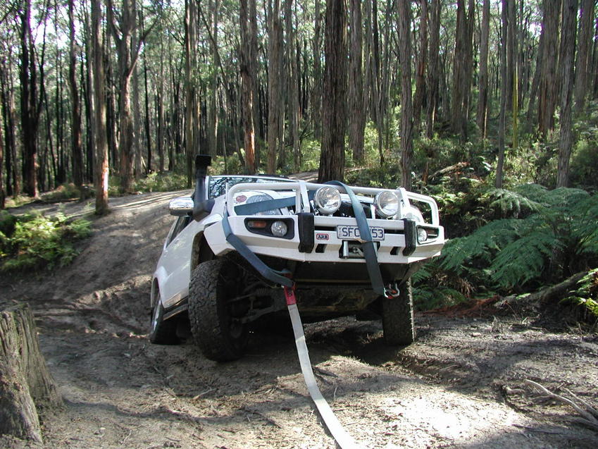

This was testing the recovery points on a Prado. It was doubled up as a back-up in case the main location failed (which it didn't). We used to do tons of real world testing, not just in the workshop.
