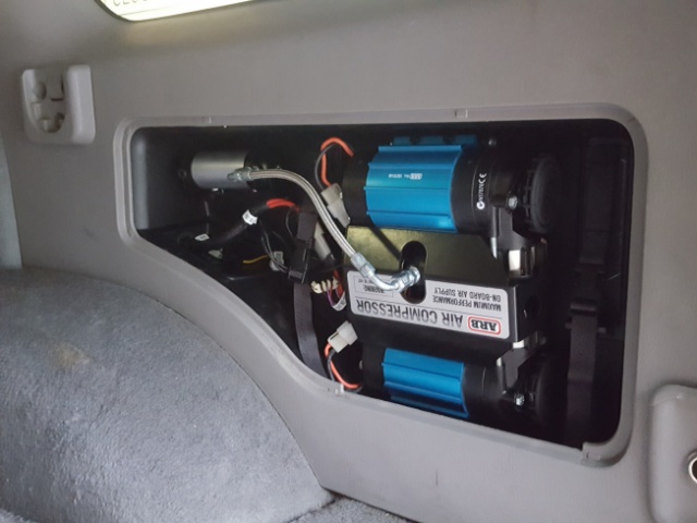

My twin would have been tight up front, so I opted for a rear cargo mount solution. You do have to extend the loom wiring if you go this route though.
That's exactly where I put my ARB dual as well, in the rear cubby. Only I'm lazy (so far) and just put a quick release poking out through a hole in the cover.
My wife's '96 has the compressor tucked inside the driver's side rear quarter panel (behind the plastic) and a tank underneath where the spare used to be.
