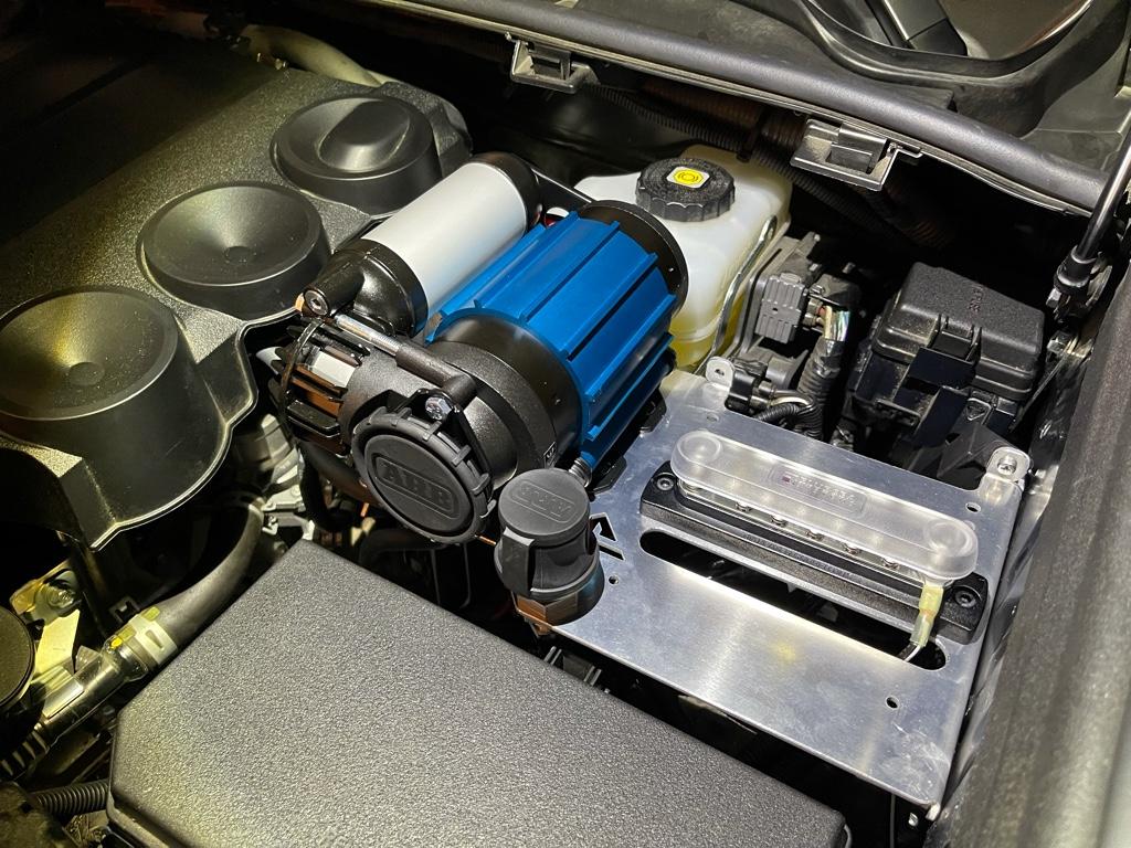

2020 ORP here. I chose to install the compressor on the drivers side of the engine bay. There are other options for location but I made the decision on location first and then started researching mounting options.
The big change over prior year 5th gens is the additional fuse/relay box behind the main fuse/relay box. Slee sells a relocation bracket but it’s not necessary. You can repurpose the existing bracket and relocate it. No cutting or drilling required. PowerTrays has those instructions on their website.

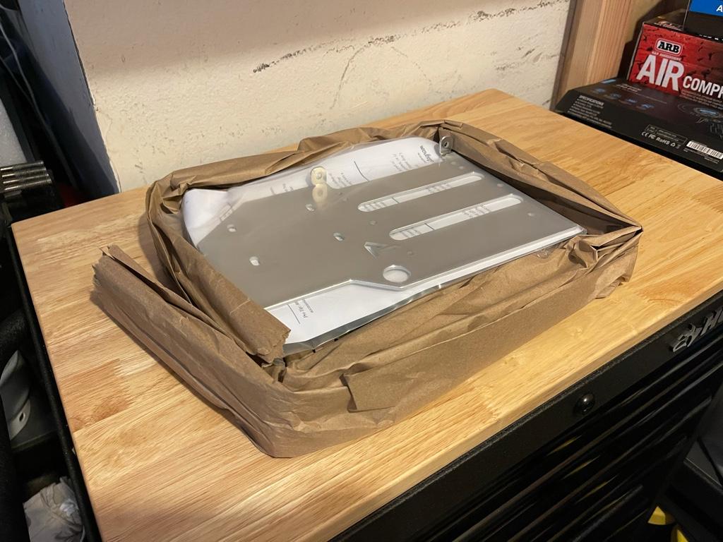

Package arrived via USPS within two weeks, even though their website said it was sold out and would take 3-4 weeks. It was well packaged.

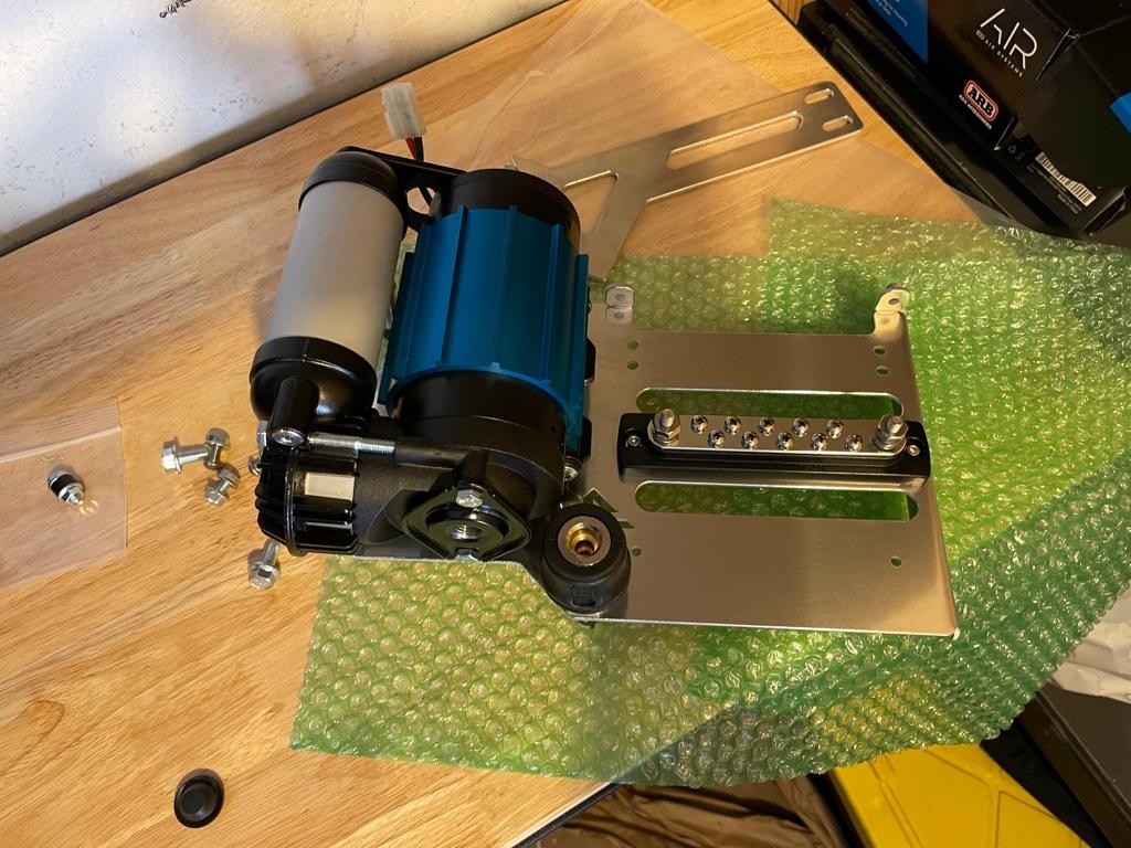

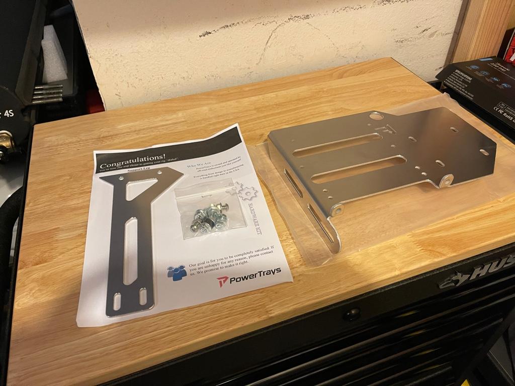

Supporting arm glued to the instructions along with installation hardware.

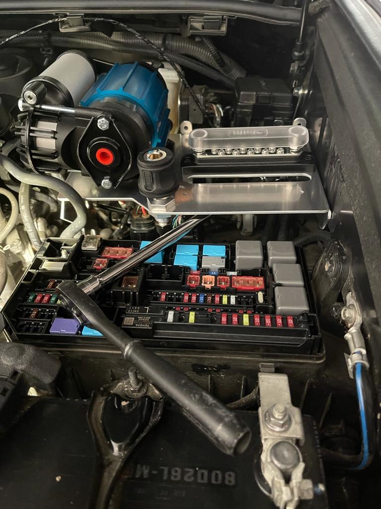

Compressor bolted up.

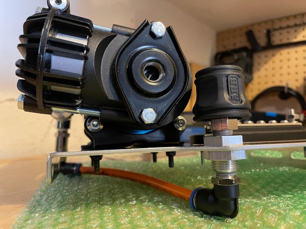

One of the deciding factors for me on PowerTrays was the clean and precise cuts and ability to relocate the quick coupler. The relocation kit is pictured here. Using this kit I can tuck away the wires, pressure switch, and tee connector for a cleaner final installation.
Note the relocated fuse/relays box in the back. It does make accessing the firewall wiring tricky but it’s easy enough to remove. I ran my switch wires through the firewall before bolting in the relocated fuse box and before bolting in the PowerTrays.

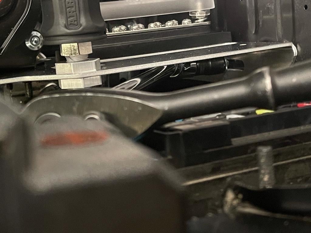

Definitely use the recommended 10 inch ratchet extension bar with a universal joint to make tightening the bolts easier. Space is tight back there!

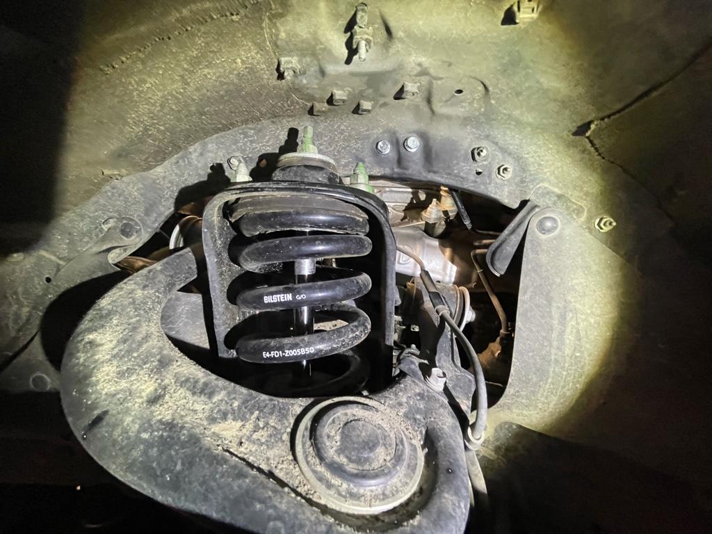

There are two bolts that run through the fender here to attach the support arm. Just above and to the right of the suspension components. It helps to jack up the front driver side to get some extra room to work. I did not remove my wheel but that might give you a more comfortable working area.

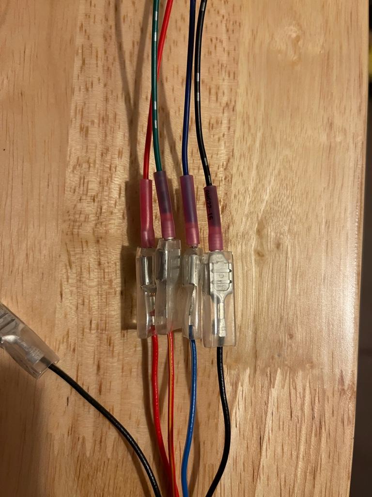

Top: AOB wires
Bottom: ARB isolation switch wires
*Note: after install the light on the switch stayed illuminated regardless of switch position. I flipped the AOB green and red wires and that eliminated the problem. Pro tip: attach spade wire connectors to the end of your AOB switch wires.
AOB -> ARB
Red -> Red/Ylw
Green -> Red
Blue -> Blue/Wht
Black -> Black
I did not connect the second black wire on the ARB side.
I taped off the connectors for switch 1 and switch 2, as well as the corresponding connectors near the compressor.

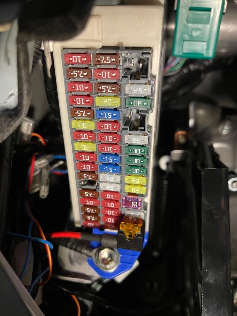

I did not care for the dimmer connection, so I taped off the ARB blue/white wire as well. I connected the ARB red/yellow wire to the ACC slot in the interior fuse box using an add-a-fuse and a 15 amp fuse, then just zip tied up the excess wire and tucked it out of the way.
