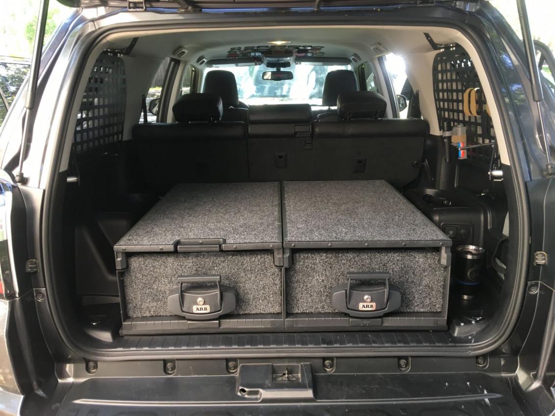

ARB Drawers INSTALLED!
Just got a set of these installed, using two preinstalled Riv Nuts and adding two more in the front of the trunk, near the back seats. I didn't use a wood interface like above, just the ARB spacers and straight into the RivNuts. Took a full afternoon to get them in but they feel solid and look pretty good.

I didn't take many pics during the install but if anyone is after tips or info give me a shout.
Biggest draw back to these drawers is they are not full extension. Not a deal breaker as the build quality and feel is good, but still a shame in 2020 when so may full extension slides are available.

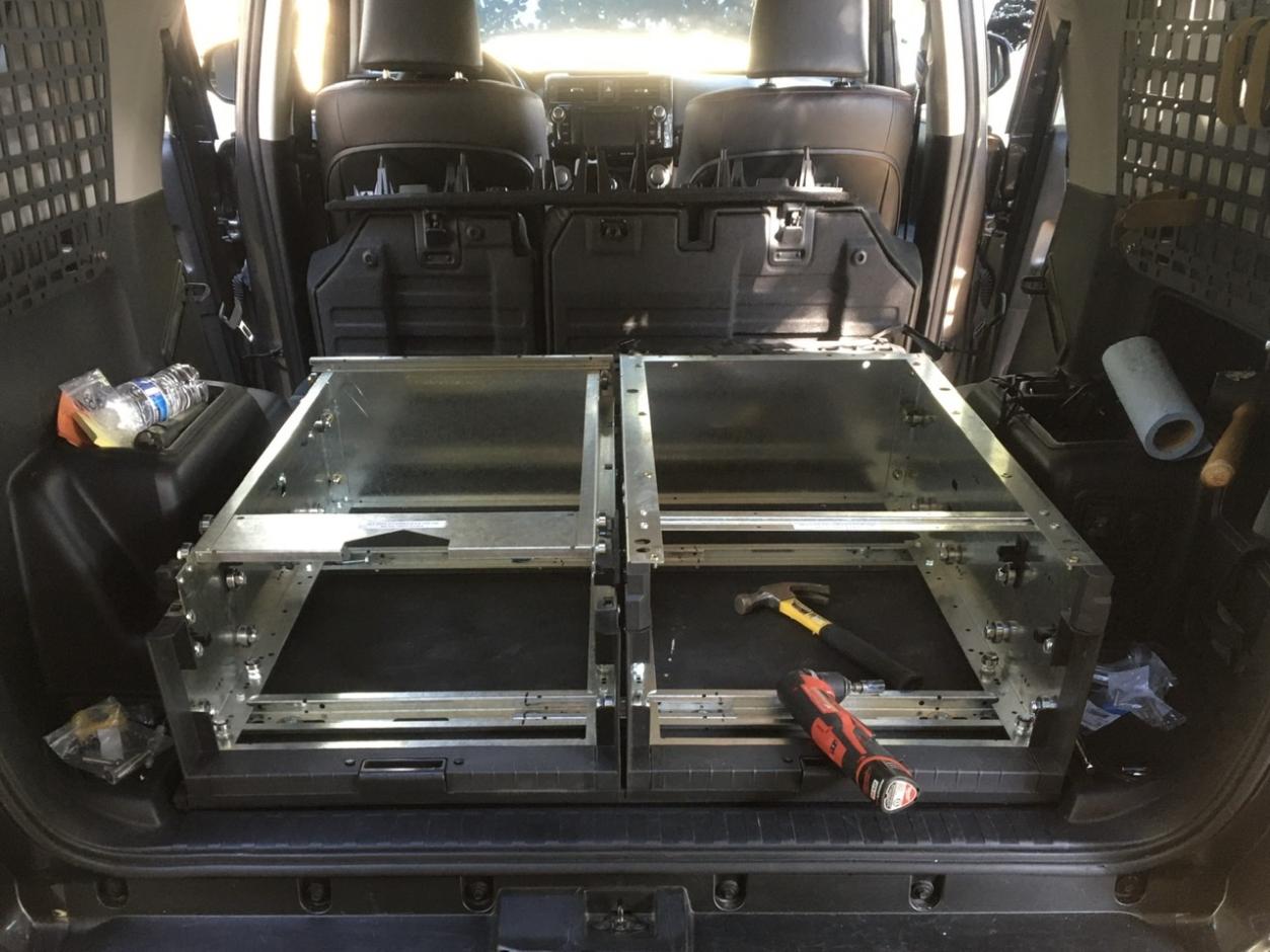

Drawers are installed but still need to finish the side floor kit.

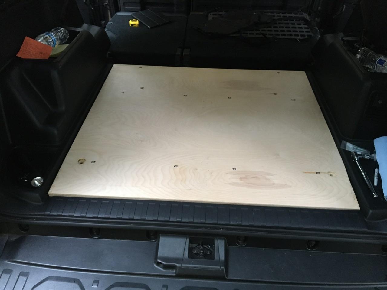

I used the plywood in lieu of the ARB spacers. I secured the plywood base directly on top of the carpet and left the foam in place. I did remove the angled part of the carpet to help keep the plywood level.
I drilled holes through the carpet & foam so my mounting bolts go through without any issues. I recessed the holes that mounted the plywood to the floor so the bolt and washer was flush to the top of the plywood. That way it did not interfere with the ARB drawer frame.
