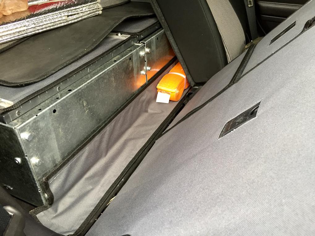

But I figured out where he drivers side hole was. Haha. Might have damaged the thread a little. :(
AND - figured out how to FIGURE out where the other one was as well.
On the underside. Just look for these things.
Close up
So proud of myself. Look at me... being all handy.

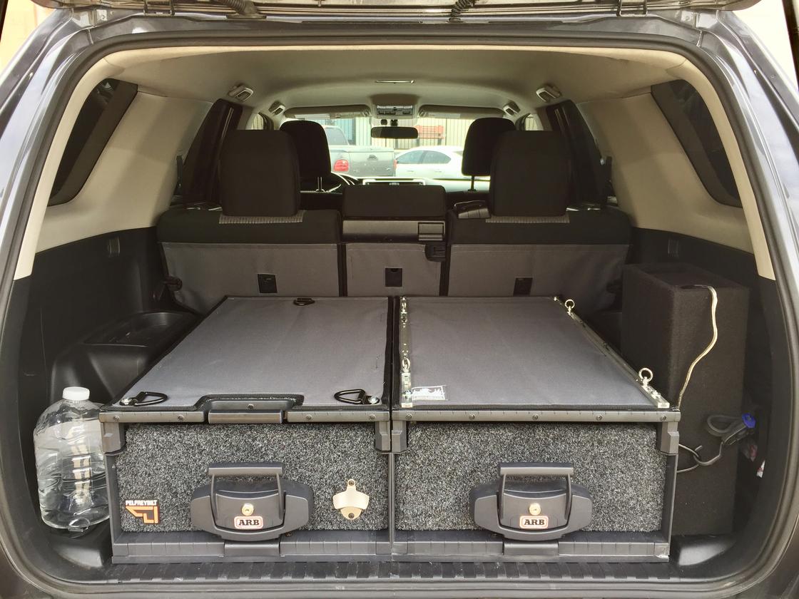

I just got my drawers today! I think I am going to do the plywood trick with carpet. Is there anyway I can get one of you guys out to Denver to help me with the install?
I also ordered the Universal Side Floor Kit from ARB, part number 945FK, since ARB doesn't yet make a side floor kit for the 5th Gen. It is intentionally wide, so that you can cut to contour to the 5th Gen.
I think I would need to install the Universal Side Floor kit prior to making all my marks and bolting everything down.

And in case anyone was interested if seeing a side floor kit works, it does! You'll need a plunge router, dremmel metal and wood cutting wheels though. It's a universal side floor kit. So measure twice, cut once.

Nice work!!! Did you end up drilling into the frame to mount the drawers?
Thanks. I followed the guidance from JasonKoko above for where the bolt holes were covered up and ArrArr's guidance on using a 3/4" plywood sheet to bolt the drawers to. So, plywood bolted to car and drawers bolted to plywood.
