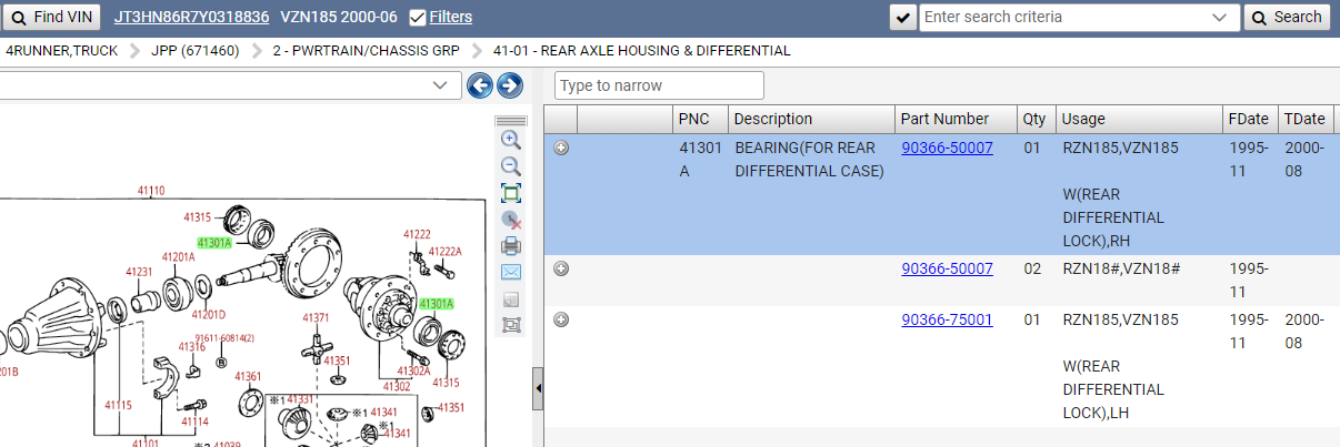

You'll need two of 90366-50007. I use this website to look at parts diagrams now: TOYOTA 4RUNNERVZN185L-GKPGKA - POWERTRAIN-CHASSIS - REAR AXLE HOUSING DIFFERENTIAL | Japan Parts EU
The part numbers are valid. If you have a factory diff lock than 2 separate part numbers are needed, 90366-75001 Driver Side & 90366-50007 Passenger Side, no diff lock than 2x 90366-50007.
