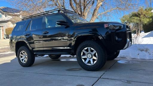

I just put on the OME medium load springs with the Nitrocharger dampers, along with the OME UCAs, on my 2015 Trail. Rides great and came in at a good value. With the KDSS, it rides better than ever. Tires are 255/80 17 (33”) Wildpeaks. For the generally slow, moderate trails I’m mostly on, it’s a good setup.
