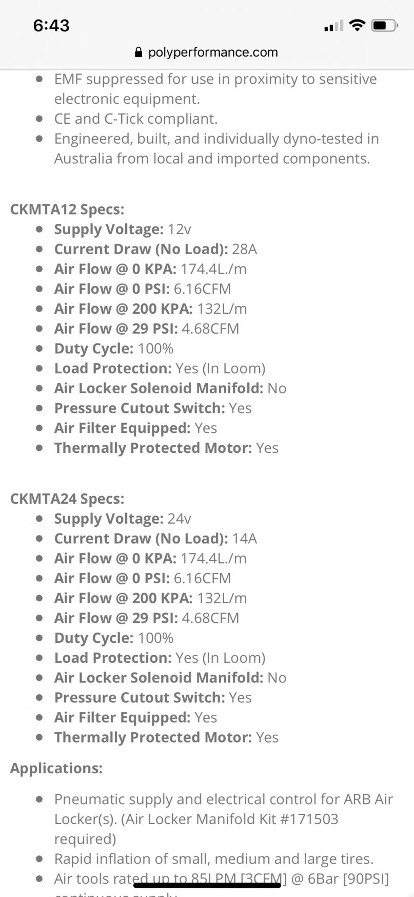

S Saxen New member Oct 7, 2020 #1 Hey everyone, Sorry for my lack of knowledge. When purchasing an ARB on board dual compressor for my 2026 4Runner (one battery) should I go 12v or 24v? Any additional education would be appreciated. Attachments 842E73F7-C1ED-431E-82A5-B6F23B9F4DD3.jpg 134.9 KB · Views: 904
<<<< Senior Member Oct 7, 2020 #3 It is an option but you need second battery installed and set up in series with original one just for the 24v compressor.
