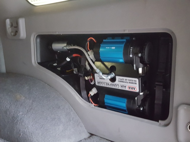

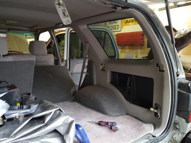

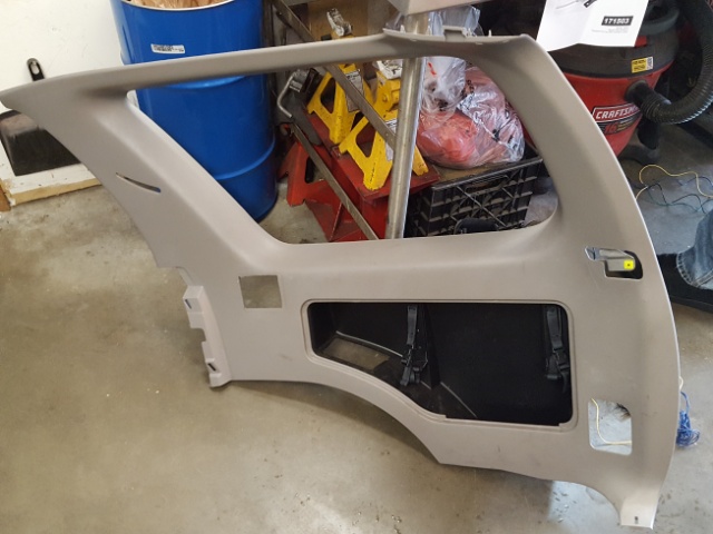

So here's a link to my ARB Twin Compressor write up for mounting the compressor in the rear cargo area.
This is an alternative to mounting your compressor inside the engine bay. I just tried to take a few pics along the way as well as tried to add a bit of what I referenced in making the choice to do a compressor mount in the cargo cubby hole area.

Thank you. Well I guess the way I look at it is everything's a bit of a trade-off. I second-guess myself a little bit every time I see someone's sub perfectly sitting in that cubby hole. And at the moment I don't have any sort of drawer system to hold all my detritus. So I have a fair amount of stuff just kind of chucked into the back. [MENTION=116467]Rock_Rat[/MENTION] had what I thought was a cool modular storage system solution. However, I recall him not really digging it in practice. I want to give a little bit of thought to what I want to do back there if anything at all.
Did you build a bracket to secure it to?
No. Not at this time. I used some large washers on the backside. The compressor itself has a bit of a frame that helps distribute weight. If I were to do it again. I would use a thin piece of metal and I would have covered both sides in a thin dense rubber. I will see how it looks, feels, and sounds for a while and make adjustments as necessary. The plastic it secures to is fairly stout though.
