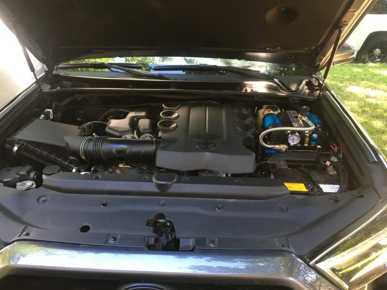

Driver’s side with the Rago mount. I mounted my sPOD on the passenger side (not shown in this picture).
