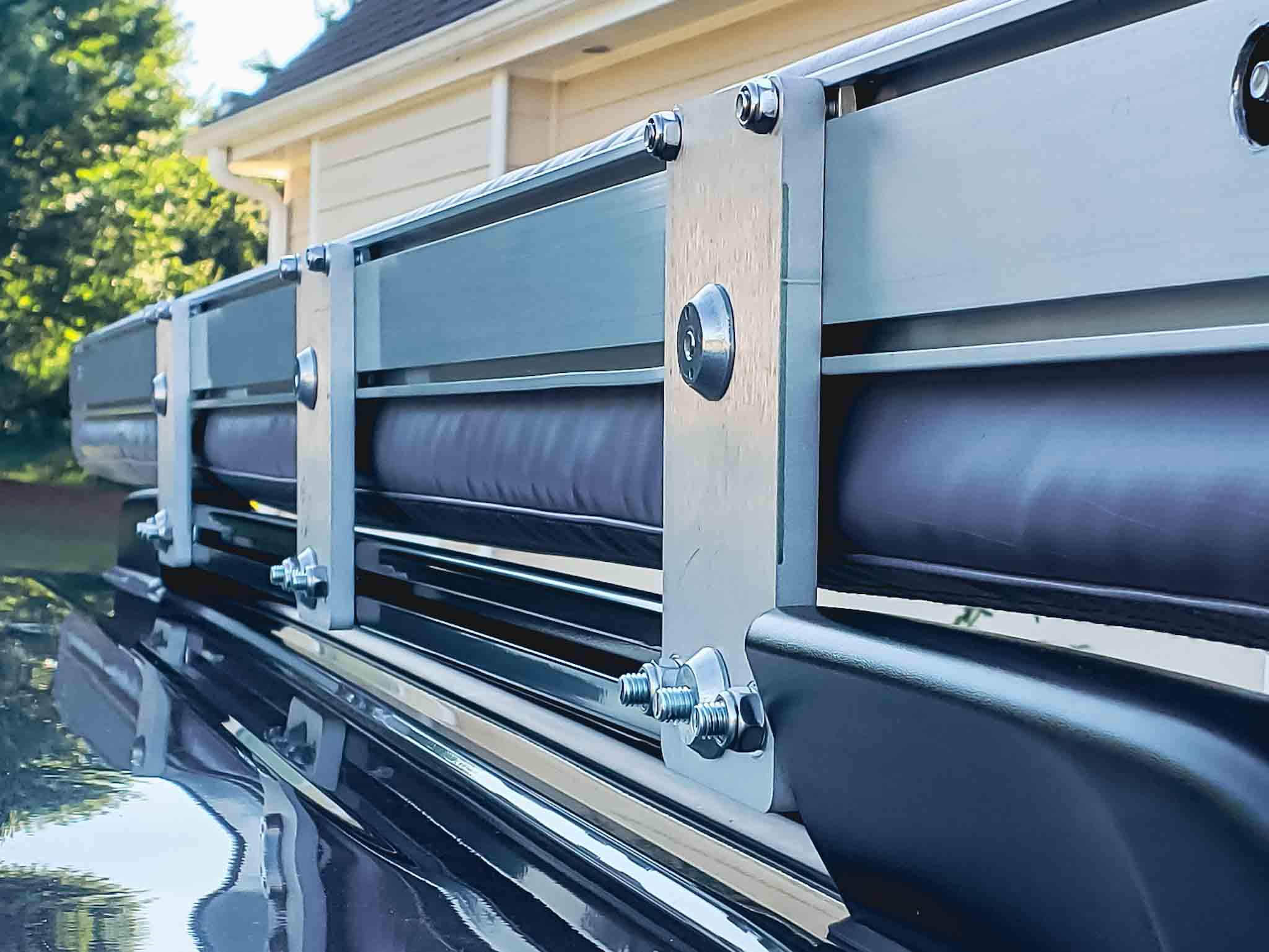

Ducrider, those look like what I need. I’ll just have to order the awning First and go from there. Now I just need to find the Specifications on the rack in order to get the correct brackets.
Hi Maadcaap, I just ran into your post after a Google search on how to mount an ARB awning directly to the factory rails. This looks like a great solution. Would you mind sharing the design/dimensions of these brackets and the material you used? My son has access to laser cutting equipment at his workplace and may be able to make them for me. I'd also buy them in case you sell them ;-). Thanks
A token of appreciation
Appreciate the drawning of the brackets. Had some made up and they were nearly perfect. Had to round out 1 hole on each bracket but, being aluminum, it was a cake walk.
