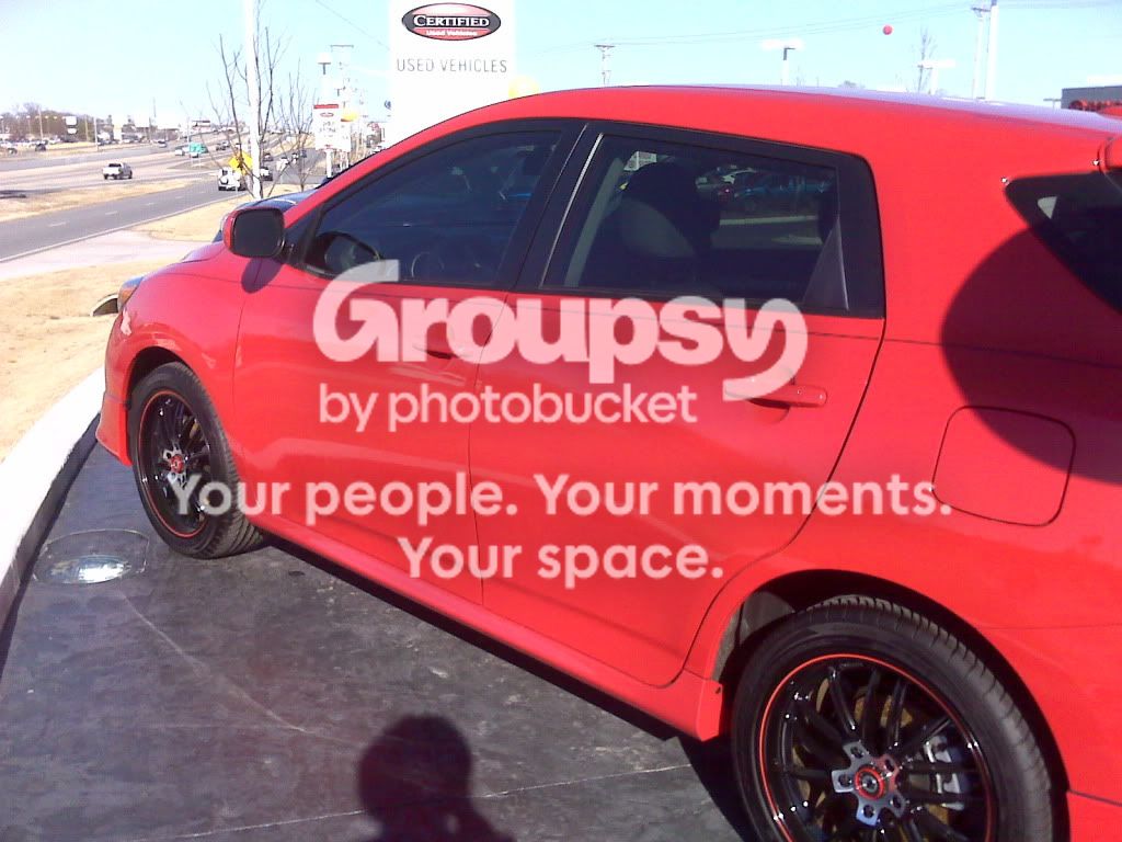

Well we actually have good news about this! We took our Matrix in for the final repair attempt before legally demanding a refund. Now, one piece of info I didn't realize I had left out was the fact that our Matrix had dealer installed aftermarket wheels and tires. 18's to be exact. After the second Regional Toyota Tech coming to Little Rock to look at the vehicle they finally decided that it's the wheels and tires causing all the steering problems. (If they would have put stock wheels back on it in December like I asked them to Toyota would have saved themselves 2 trips here but nooooooo I was crazy for even asking and guess what the Tech ended up doing yesterday...yep that's right he put stock wheels back on it from another Matrix on the lot!) The Tech told us that after all this there was nothing that Toyota would do as a manufacturer and that we needed to take our complaint up with the dealer we purchased the vehicle from which happend to be the dealer we were sitting at. They kept telling us that there was nothing they would do since we bought the car the with the aftermarket wheels knowing that they weren't genuine Toyota parts. After 2 hours of arguing with them (and having the Toyota Tech on our side saying that the only real fix for the problem was to put the stock wheels back on) we walked out stock wheels, and larbor to put the NEW stock size tires on, balanced and everything for FREE! I can't say that I am happy with this decision simply because we bought the car because of how it looked with the aftermarket wheels
BryansCar.jpg~original
we wouldn't have really even considered it otherwise. The only good thing about all this is now we have a car that's safe to drive again even if we hate how it looks. We also have a 99 Honda Civic SI that my husband is driving daily now. I think we're just going to sell the Matrix. (I have a 2010 SR5) The major down side to all of this though is that I don't think either of us will ever buy a Toyota again. We have had so many problems with not only the car but the customer service too. Hopefully no one else will have any problems like us. If you do start to have problems and start getting treated badly, do whatever it takes to MAKE your dealership listen to you up front. It will save you a lot of time if you do!!!
