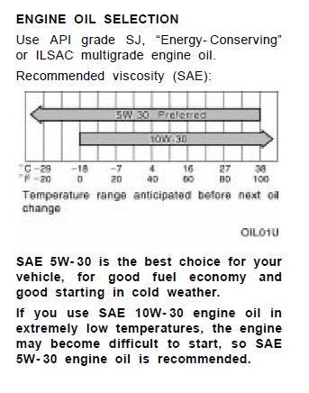

You are running 10W-30 in your rig? May I ask why? Our machines call for 5W-30.....
5W-30 is preferred but 10W-30 is fine for temperate climates.

Because I can. This engine seems not to mind heavier weight oil. I could probably run straight 30w in it and be fine.

I never thought of running a heavier weight oil but might try it.
