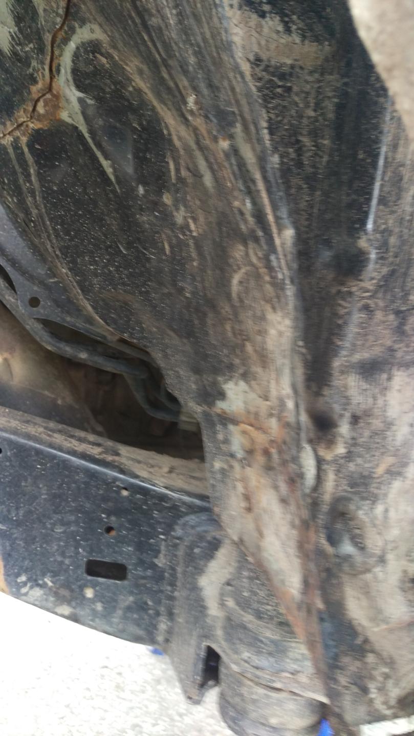

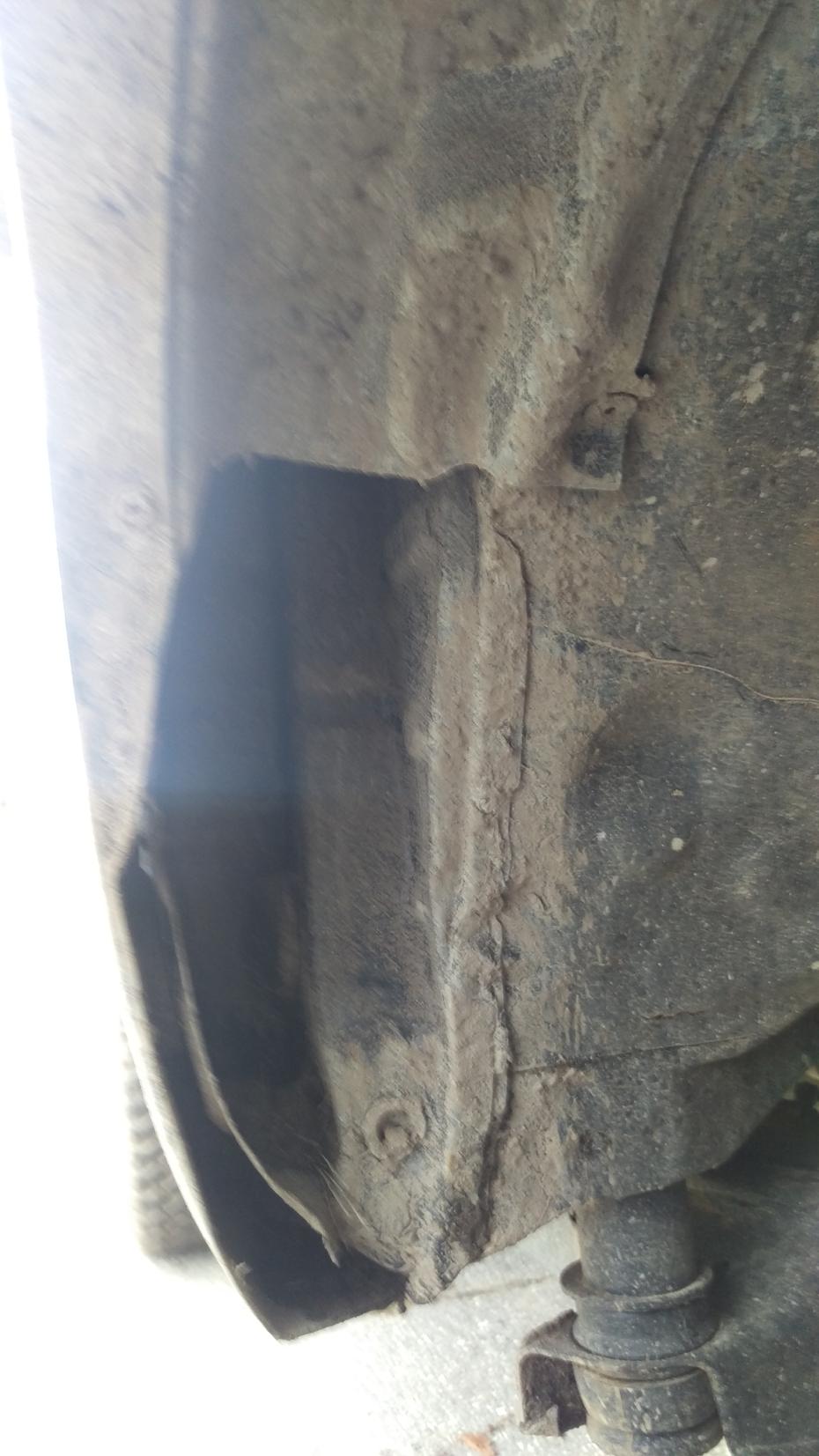

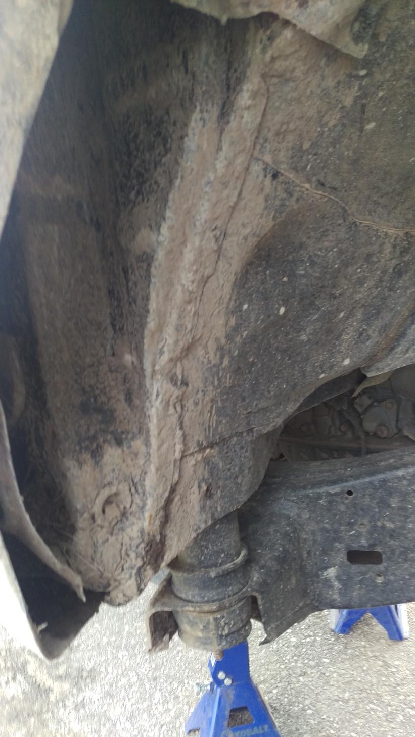

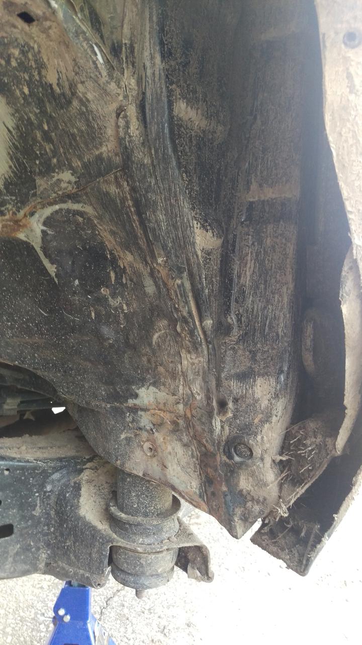

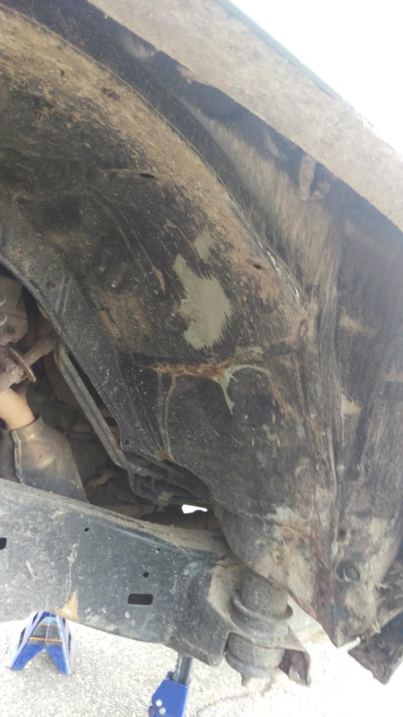

Here's some pics of the front fender wells and what I've trimmed. You can also see the pinch welds are hammered flat. Sorry, truck is kind of dirty right now. You don't need to trim as much off the front bumper as I did. I did that to help approach angles. uploadfromtaptalk1446408640083.jpguploadfromtaptalk1446408657788.jpgwhere the paint is scuffed off is where my tires were running recently. I just hammered them in more.
uploadfromtaptalk1446408738583.jpguploadfromtaptalk1446408760288.jpguploadfromtaptalk1446408786318.jpg

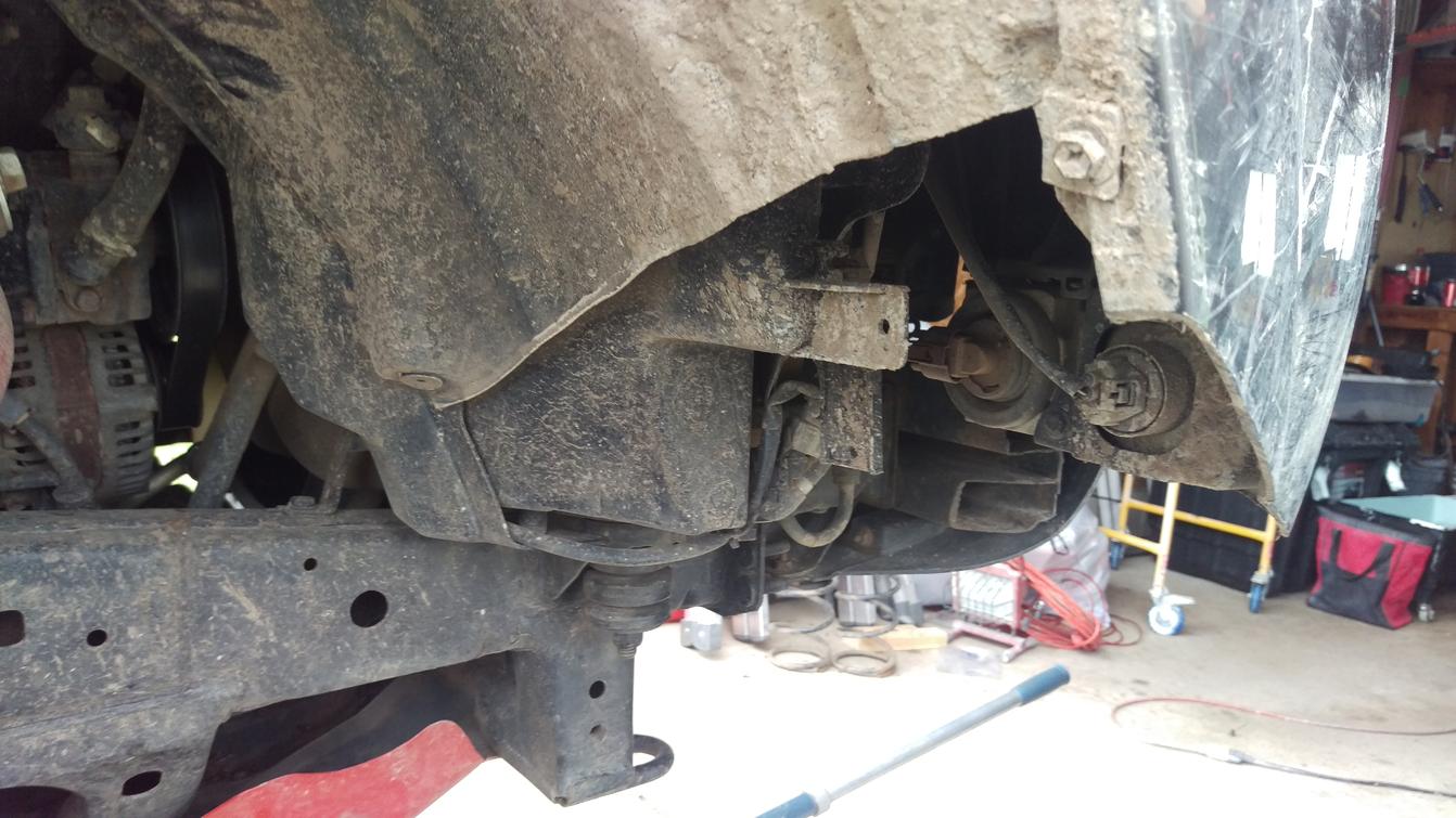

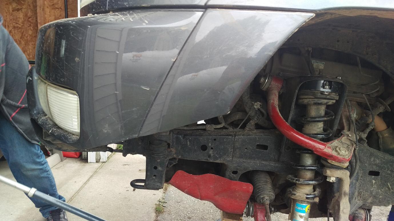

uploadfromtaptalk1446408847730.jpgHere's how I cut my front fender to help approach angles. I used to hit everything with my bumper.
