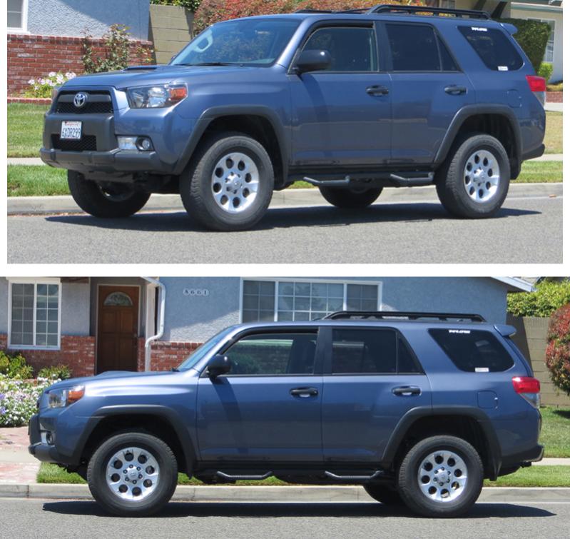

I added 5100s with 0.85 setting. No more rake, almost level and the 5100 were only a little firmer, reduced the nose dive and felt a lot better for off road trips. The photo is with OEM tires, before the AT2s.
Thanks for posting this. This is exactly what I want.
