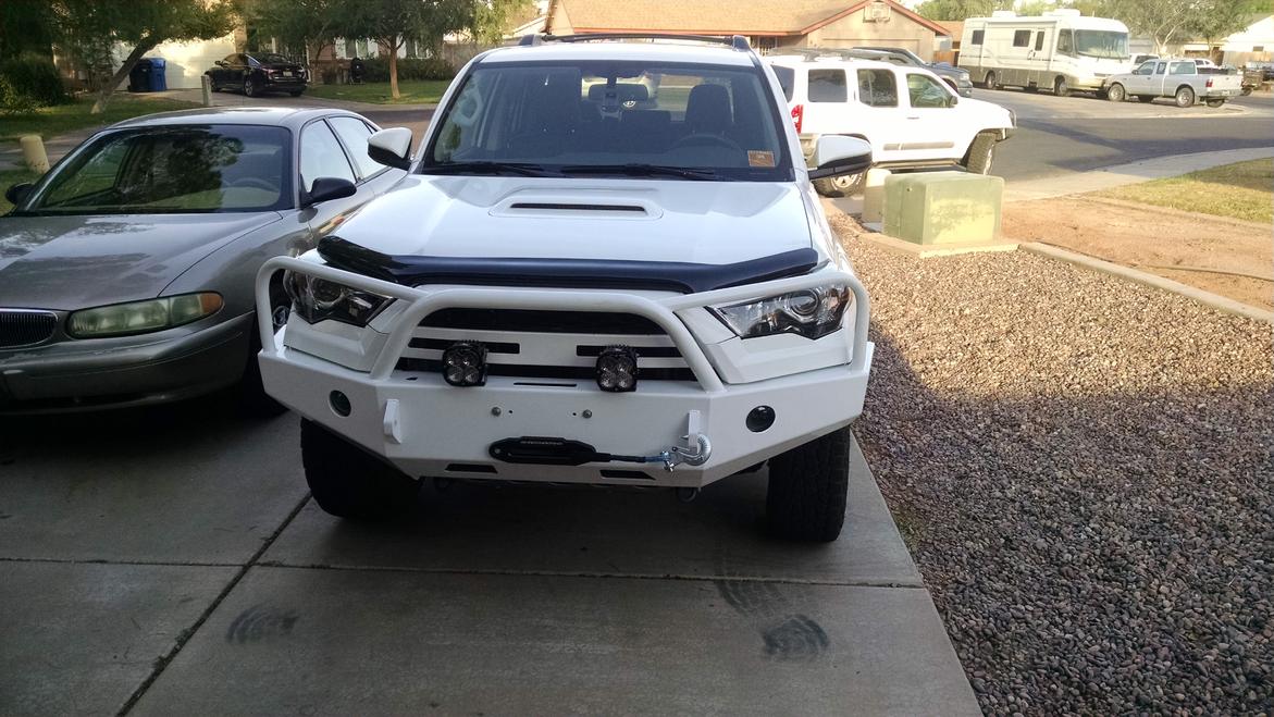

I've got a 2016 TRD pro myself - I've added a shrockworks front bumper and Warn 9.5 xp winch. The front end now sags by about 1" from where it was, and I just want to get it back to original height.
Does anyone know if you can retrofit the Bilstein 5100 shock with the Toyota spring and accessories? If not, what is the best leveling kit for a 1" lift overall (which is 1/2" on the shock proper)?
