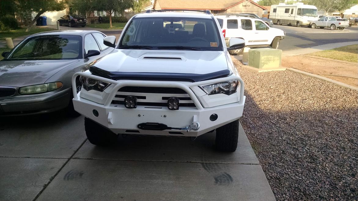

I've got a 2016 TRD pro myself - I've added a shrockworks front bumper and Warn 9.5 xp winch. The front end now sags by about 1" from where it was, and I just want to get it back to original height.
Does anyone know if you can retrofit the Bilstein 5100 shock with the Toyota spring and accessories? If not, what is the best leveling kit for a 1" lift overall (which is 1/2" on the shock proper)?

No, the Pro springs have a larger shock body and different valving than the 5100s.
You need new springs, not additional perches on your shocks. You have added a ton of weight to your front end.
