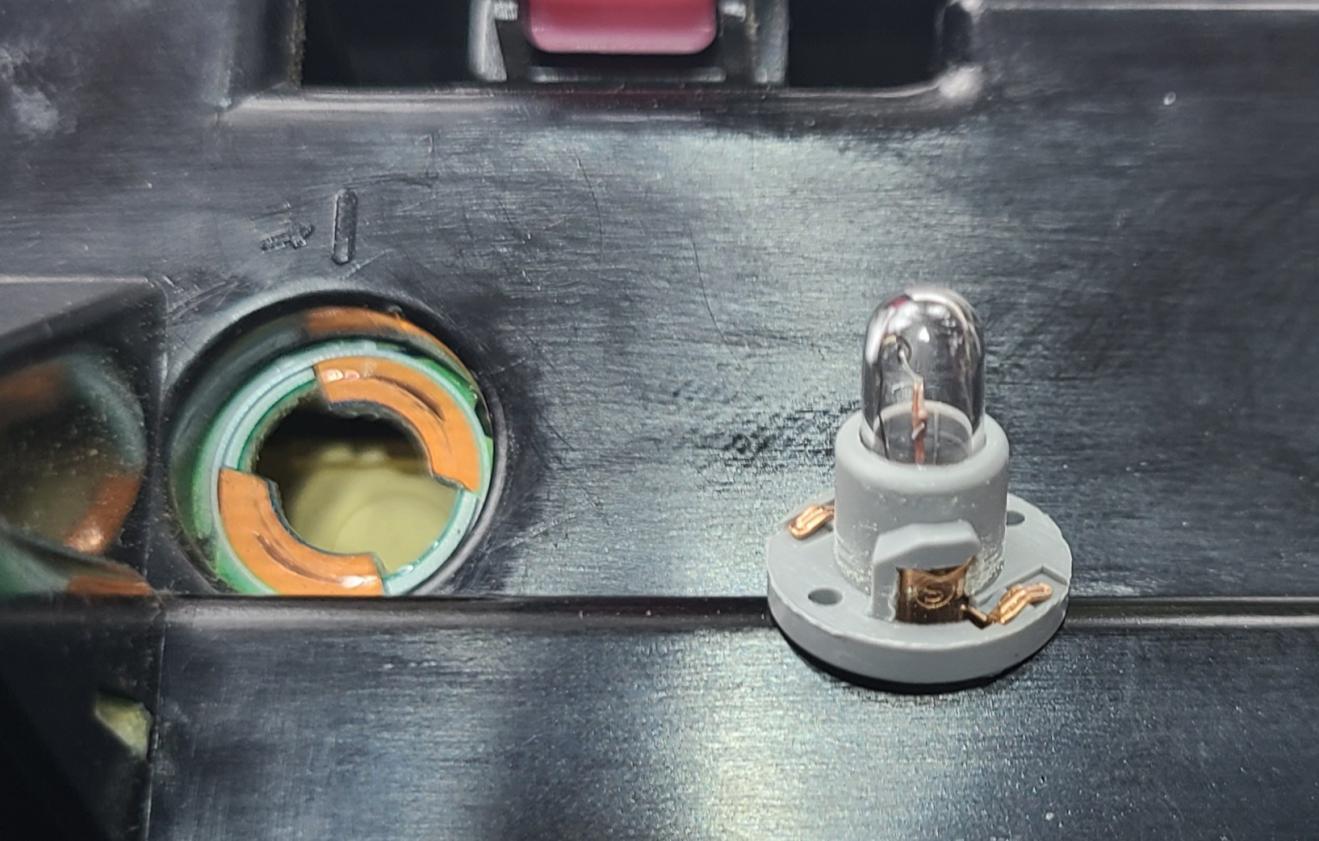

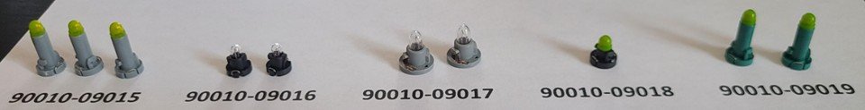

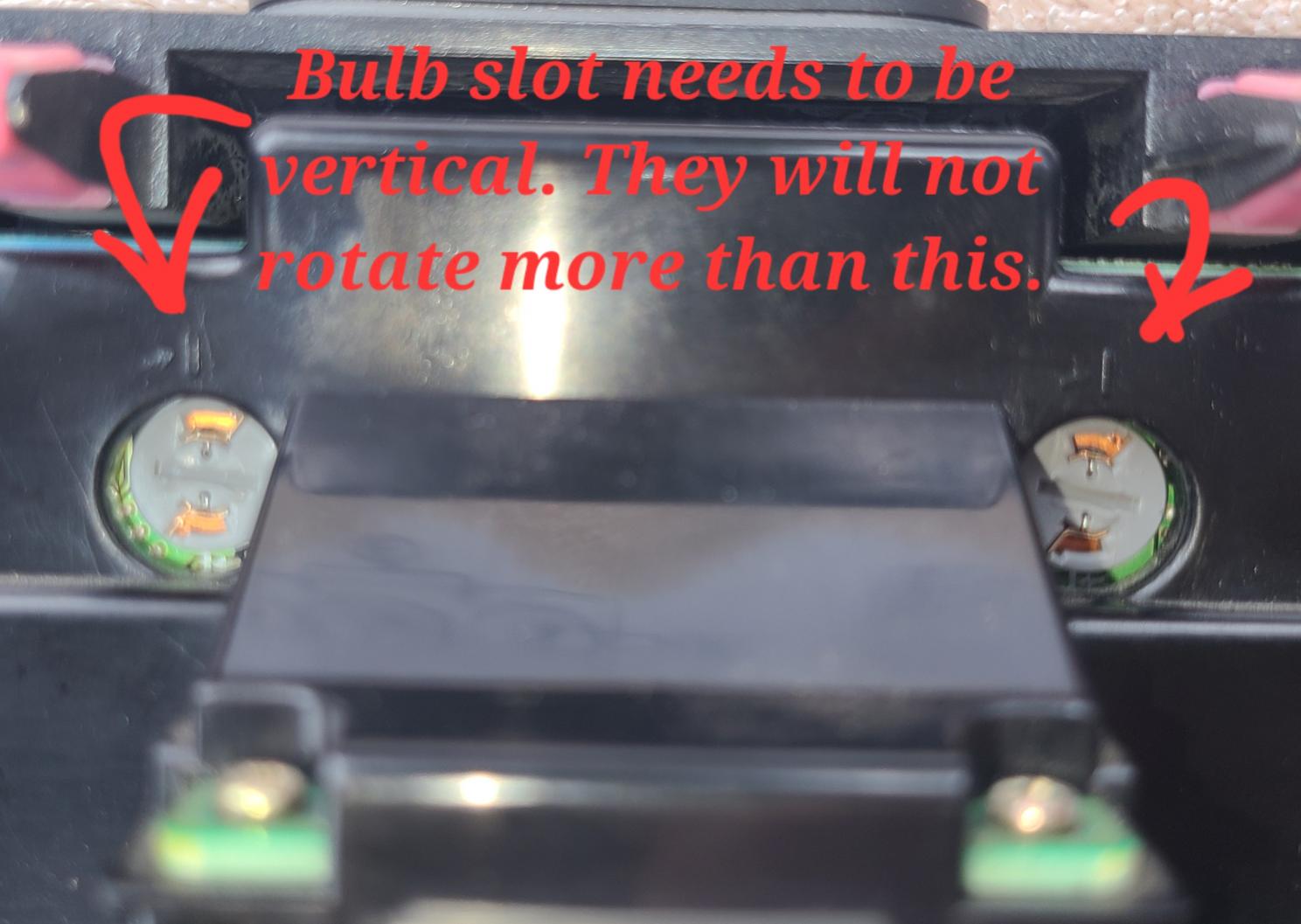

I bought this package of OEM bulbs via Amazon a week ago because it seemed that locating LED equivalents was just too much trouble. Each new bulb fit fine except for the 90010-09017; the two bulbs that rear-illuminate the LCD clock. The rear of the bulb has a vertical hash and, once properly installed into its socket behind the clock, the bulb+base must be gently turned about 1/4 of the way so that the hash is vertical and aligned with the similar hash above that socket. My two new bulbs will not rotate enough for their hash mark to be vertical. Therefore, the bulb base's metal contacts do not touch the socket's metal contacts so....no electrical connection=no light. The seller (Toyota of South Miami) said there is nothing they can do because the bulbs are the correct part number for my 4Runner. I have tried forcing the bulb to rotate more, but the shape of the base prevents it from turning more. The package of these nine tiny bulbs was $50!
I don't understand why this has become such a problem, I just want a freakin' illuminated clock.

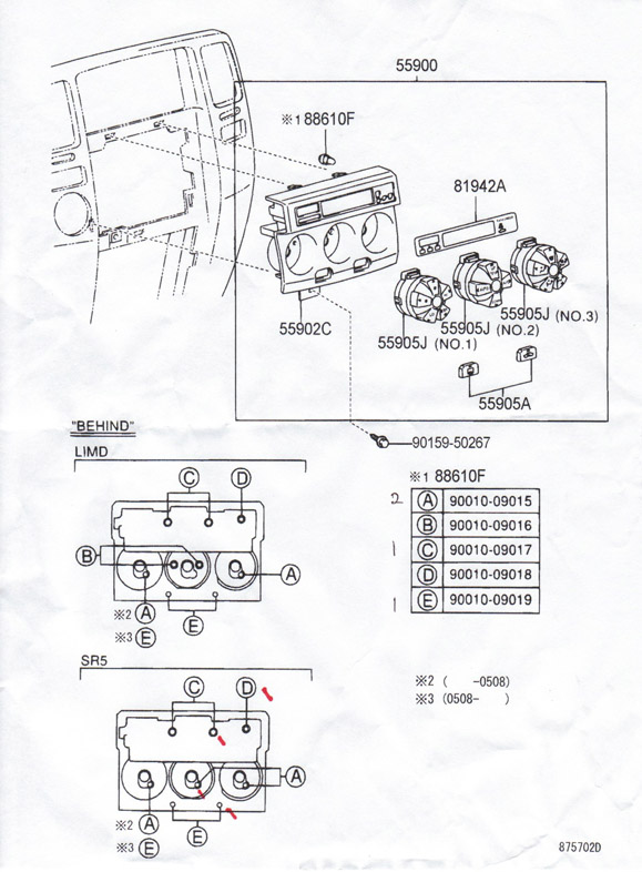

You haven't mentioned which model T4R you have, the Limited has a couple of different bulbs than the SR5 and Sport Edtion because of the dual zone AC controls.
The attached image shows both version of the control panel and which bulbs are needed for each model display panel so you can compare the part numbers to the ones you purchased.
Have you compared you old bulb housing to the new housing, you also may be able to remove the bulb from the new housing and put them in the old housing.

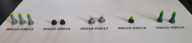

I am attempting to specifically identify LED replacements for the OEM incandescent bulbs in the climate control panel in a 2007 Toyota 4Runner SR5. Attached photo reflects those OEM bulbs and bulb numbers.
I've seen in other posts that the Samsung 5630(t4); 5630(t3); and 5628(t3) bulbs will work but details are lacking on specific sources and specifically which of these bulbs replace which of the OEM incandescent bulbs.
Also, when trying to identify LEDs, I don't see addressed anywhere the varying height/length of the bulbs.
Finally, I have scoured internet sources and the 5628 is not to be found anywhere. Can someone identify where the 5628 can be purchased? Or is this supposed to be 3528 instead?
