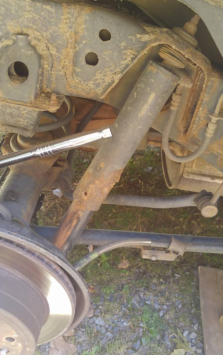

Are these xreas shocks gone?
shahsmerdis
Hi there,
as the title mentions are these shocks gone? xreas replacements are so expensive :Cry:
Thanks

Thats exactly how mine looked during replacement, in addition my xreas visibly leaked fluid. Its hard to say if they are gone just by looking on rusted exterior but I could definitely tell by the worsened comfort and stiffness they developed over the years. Just replace with the Bilsteins instead, better bang for your buck.

as far as those shocks, it is hard to tell if they are gone. You would be better off replacing as most have stated. If anything you will have new shocks that you wont have to worry about in the future. The install is pretty straight forward. If you are going to do it yourself make sure to soak all the bolts in pb blaster prior to removal because it looks like you got some surface rust issues.

If the shocks are not leaking, then they should be ok. Having that said, those shocks are in terrible shape but don't appear to be leaking. Yet. Give it time, it will. You should be shopping shocks (or the alternative and have them replaced. I did.)
