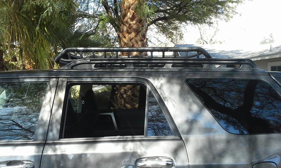

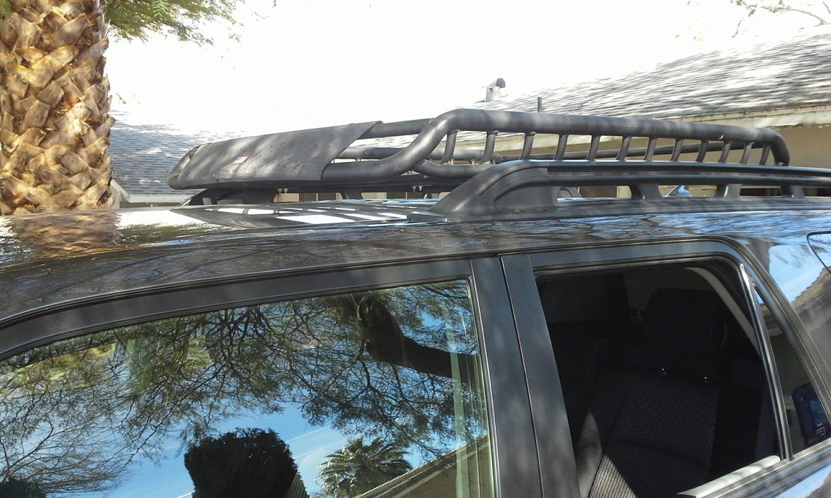

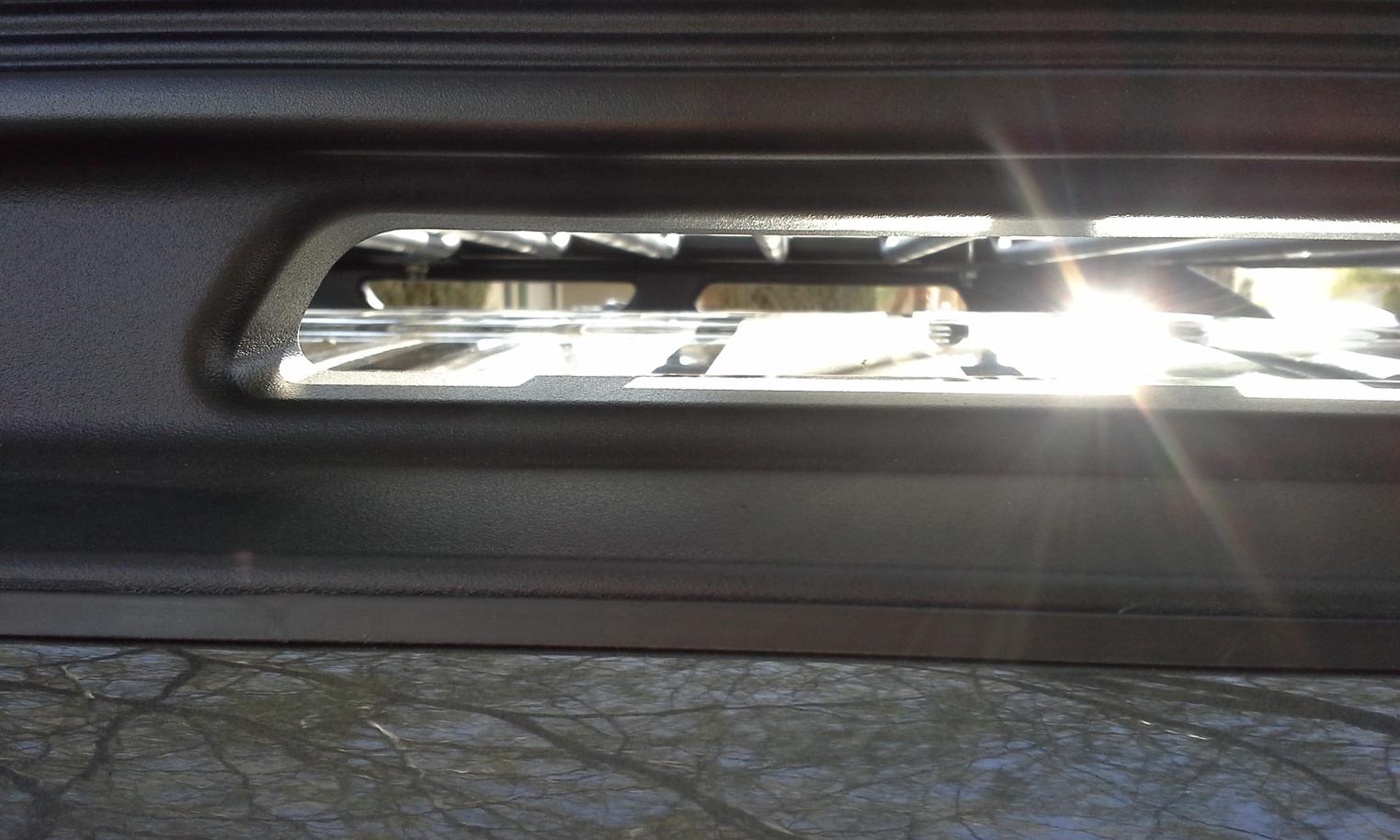

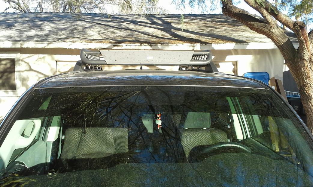

Well here we go , it fits HOWEVER due to the narrowing of the TE rack it's squeezing the rack so I'm not sure if this will work long term , here's some pics tell me what you think ? :usa2: Thanks to GabrielM for clueing me in on the TE rack , not sure why Toy. would do the rack like this . In the middle pic you can see how the rubber is up a bit .:shocked:

Here's a better one of the clearance & how it sits . Looks ok but wish I could get it back & centered more . Will see how much it pushes on the side rails but absolutely no noise very quiet . Was getting a TE rack anyhow & got a killer price from my boys at Findlaytoyota ya I said it get a hundo for birddogging :jaw:
Looks good [MENTION=78968]oljedi11950[/MENTION] and love how low the rack sits between the TE side rails. I would prefer centered or at least a few inches back.
So, the more you move the rack backward, the more the TE side rails are moving inward? That will be the opposite of my crossbars problem. Is this because of the cargo basket width or the mount that you're not able to move it further to the back?
No the opposite because rack is square the further I push it back , like you said get's shorter(cross bar shorter) and pushes it outward ! Don't want to go any further afraid it might strip out the rear .
