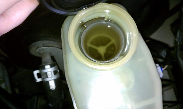

Wow, so I am getting through some much needed maintenance, I have gotten everything done I have needed with the help of this forum!!!

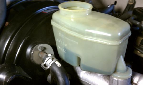

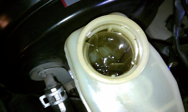

Right now I am flushing the brake fluid!! I started with my Mityvac and attempted to pump all the old fluid I could from the master cylinder. There is an area that is hard to wedge the hose in and this thing is filthy!! As you can see from my pictures, I may have to just remove the master all together and clean it out....There is a film on the sides even after its been mostly emptied. Also, I am not experiencing any braking issues that I am aware of. I don't really ever have sudden stops, but overall it seems to stop very well...Maybe after new fluid and cleaning out about a pound of brake dust from the rear drums will make them even better!!
So it looks like I can remove just the res, but anyone have any tips for getting it all cleaned out once I do? I am not sure I want to use any abrasive chemical cleaners on the plastic...Maybe just some simple green and water and then let it dry 110% before I fill it?? I also have an air compressor I can blow through it to get any left over moisture if you think this is the best way...

Stick the reservoir in the dishwasher. I will come out spanking clean.
That would be another thing I do when the GF isn't home. She tends to get a little tense when she finds car parts in the kitchen appliances dish washer, oven, freezer . LOL

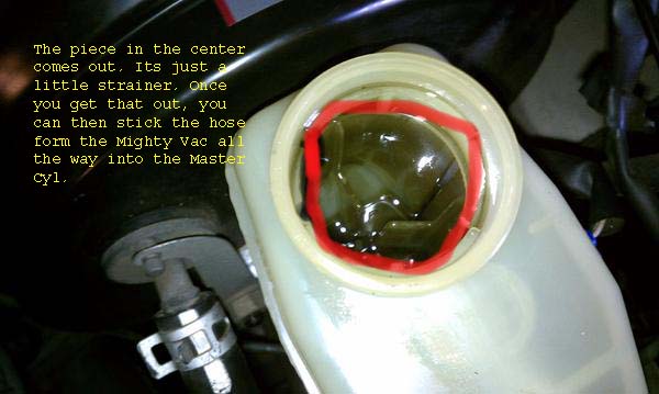

You can pull the center piece out. Its just a little strainer
I was going to make a comment similar to the one below :)
Totally on point with this one!! haha.
Well this thing is just so nasty, it looks like the filter/strainer is still in there, but it is out :(

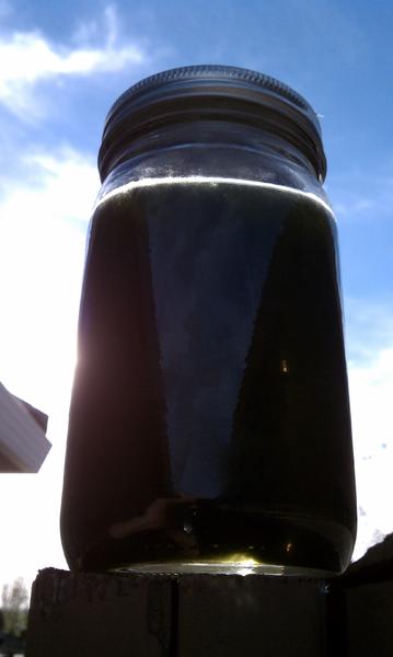

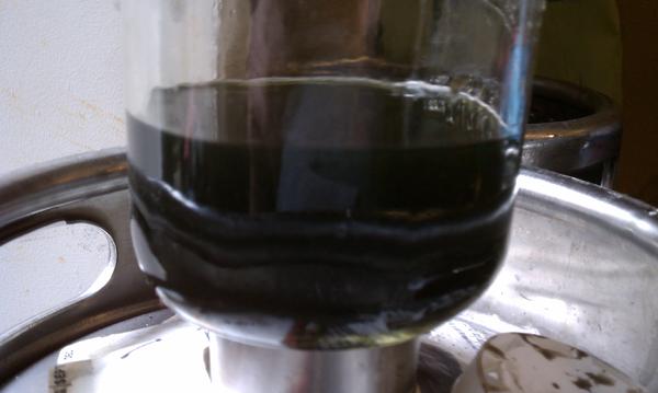

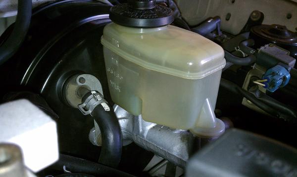

Okay, so I manged to pull off the master cylinder reservoir. I cleaned it out with pure simple green and it seemed to clean it up pretty good. I filled with new fluid and proceeded with the brake flush....What came out was NASTYYYYYYYY! I flushed the brake lines with my Mityvac, but the pedal is still a little soft after 2 full 4-wheel bleeds....So I will wait for my girl to come home so she can assist me the old school way and bleed them a 3rd time. Other wise the brake system is much better off!!
Nice and clean!!
Looks soooo clear now!! haha
Now that is some gross brake fluid, surprised I could still stop!!!
man this means i gotta hop on and do mine. You got any write ups on doing the flush and all ? that reminds me to do my rear brakes as well
Dude, that brake fluid is TERRIBLE! My 4runner doesnt' seem to have been maintained by PO's, and even it wasn't nearly that bad.
Got to love brake fluid and its hygroscopic (absorb moisture from the atmosphere) properties.
Its that bad probably because its original to the truck. Suppose to change brake fluid ever 2 years.
