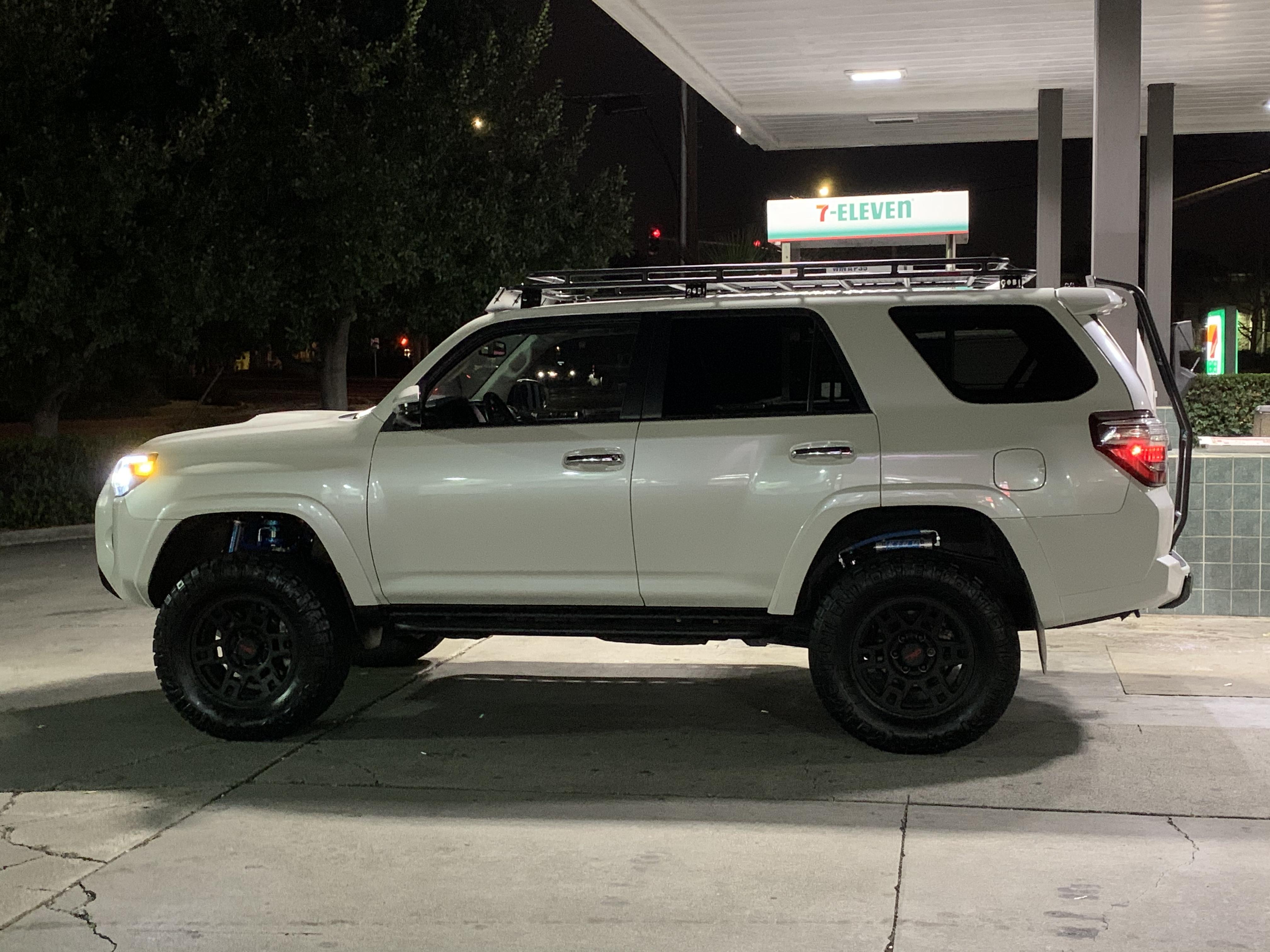

The front of your car is 1.5" higher than the rear, that's going to exacerbate any sag you're seeing. It's not surprising. Also it's a large heavy brick.

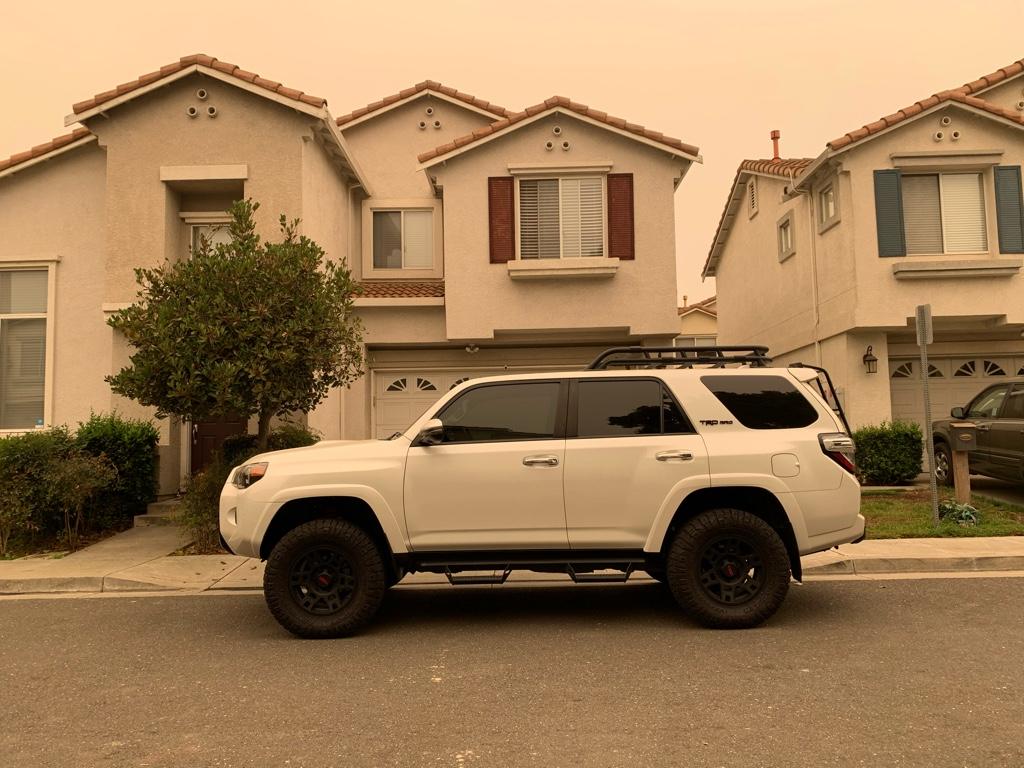

IMO, that looks like reverse rake (sag) already, so when accelerating it gets exacerbated. Your previous set up looks to be less aggressive on the front lift, too, even if we factor in an extra 1" in the front due to taller PRO springs.

This is my previous setup with cf spacers and Bilsteins trd pro springs. This setup had less sag.
It’s the current kings with icons rears 158506 which sags more :-(
