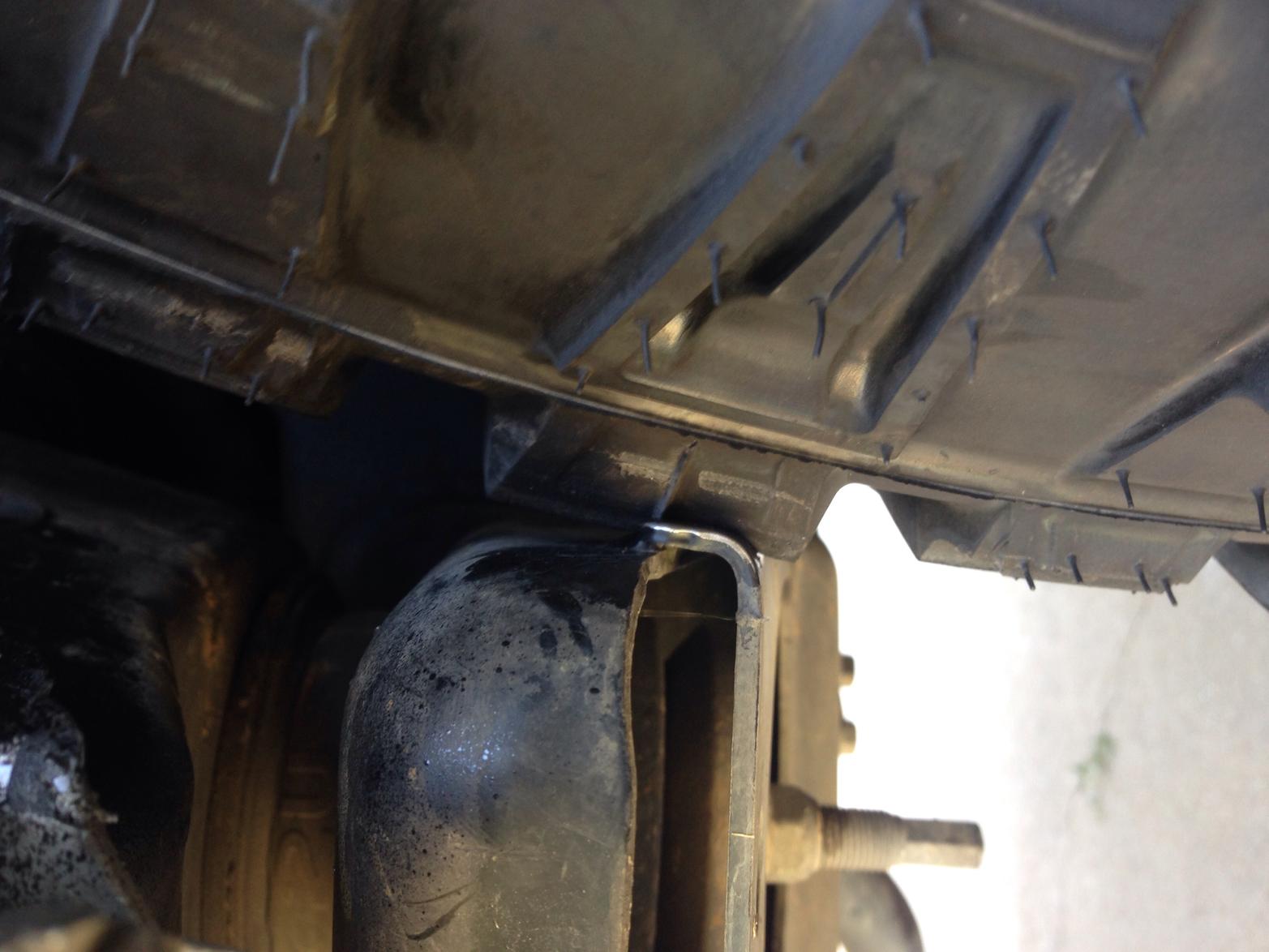

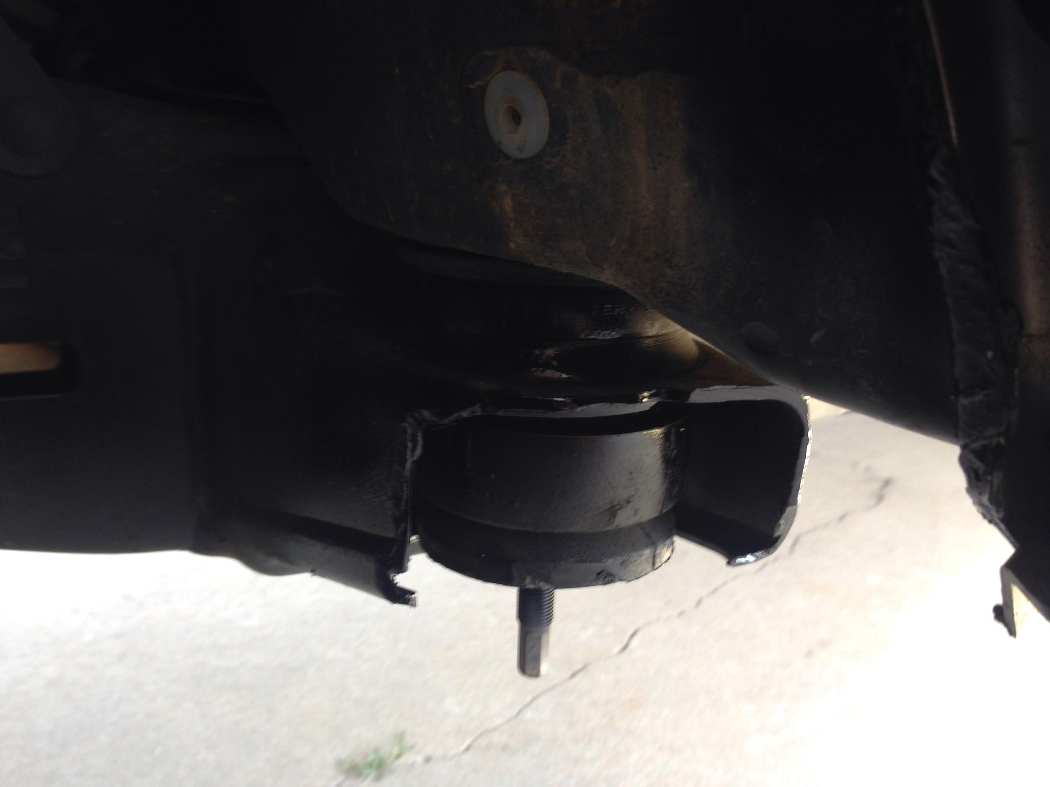

So after pushing the liners forward and trimming a small section of the bumper on only rubbed on the rear of the wheel well. Specifically the body mount, and the rear lower edge of the plastic liner. The area the covers the pinch welds. I cut the body mount, folded over the pinch weld and by doing that was able to screw in the liner a little more and now it no longer rubs.
Now I just need to fill in the body mounts to provide more structural support from where it was cut. I have icon uca and shouldn't have any problem getting 4* of caster. That may have slightly helped sense my current alignment is at 3.0* and 3.4*. But my alignment guy said the slight amount to 4* wouldn't even be noticeable but I'm starting to think otherwise.

Pics
The pic above loaded sideways but you can see what I mean... And passenger side chopped in pic below
