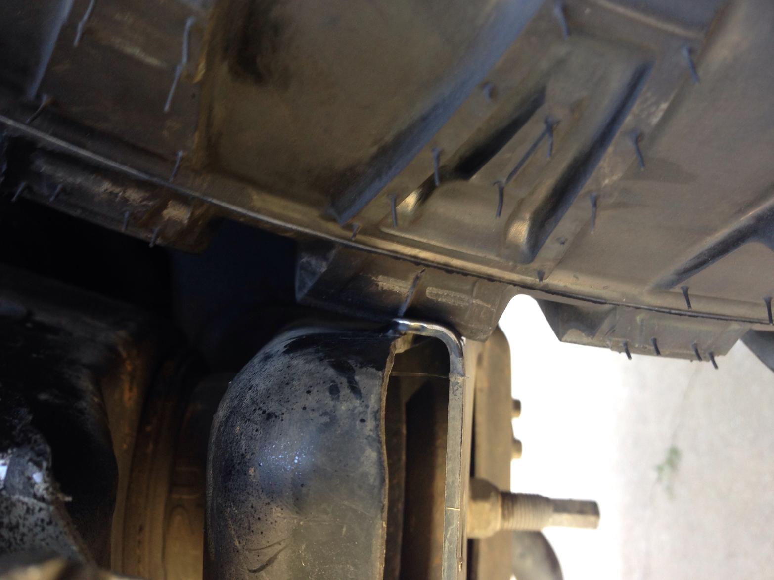

This is passenger side before chop

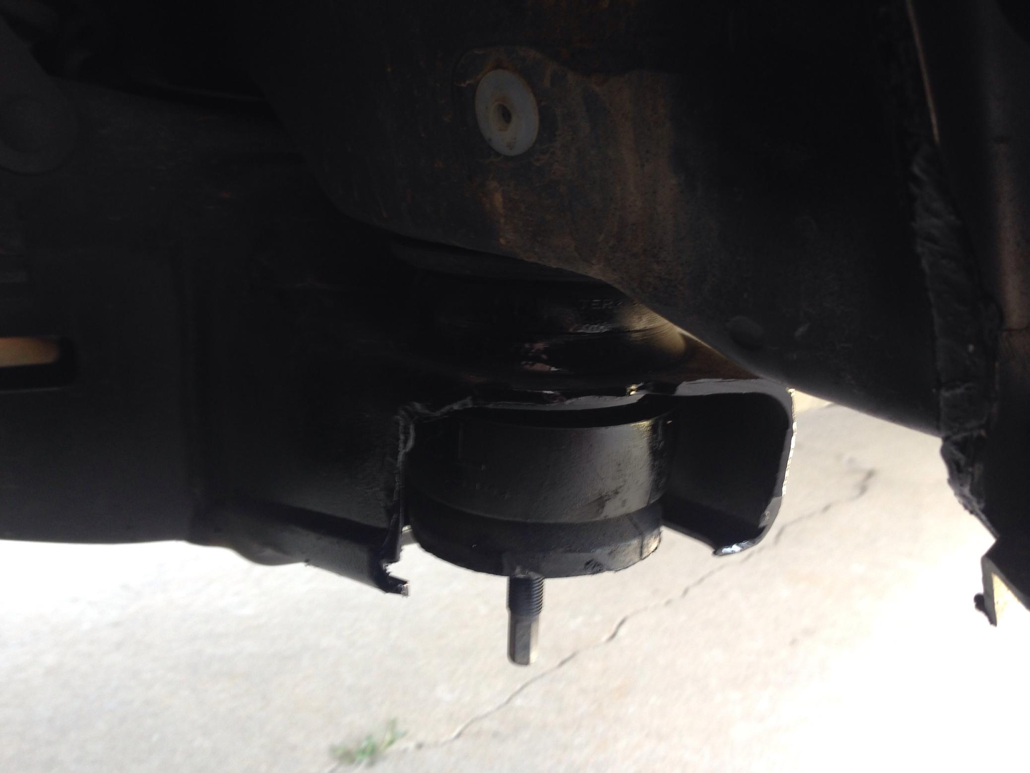

This pic shows the mount chopped off and needs a plate welded in place for more support

The forward body mount is so far back you don't clearance it out unless you've moved the firewall so far back that you modified the door hinges which I don't think you would need with 33s to begin with. Do you have a picture where you had to cut to clear?
Not at all I've read several posts about the body mount chop for both 3rd and 4th gen with 33" tires
Your thinking of 4th and 5th gen, they share the same frame basically. The 3rd Gen only needs a body mount chop for 36+ inch tires, and you would run in to the body first so you would need a body lift on top of that.
