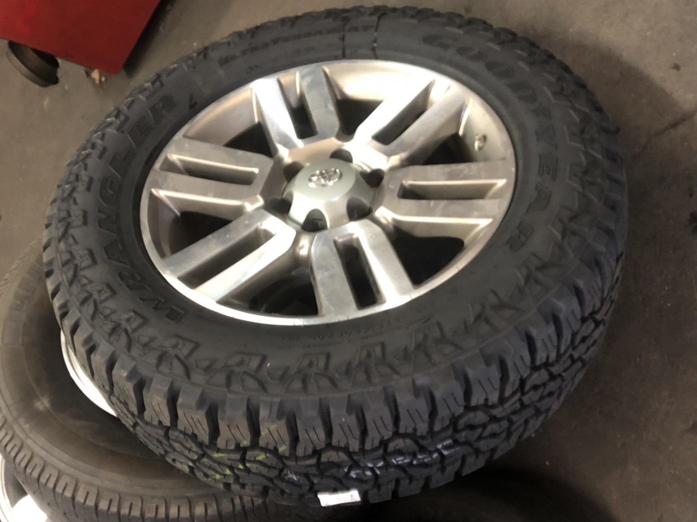

I just got a set of these Goodyear wrangler ultra terrain a/t tires, im in Northern central valley California so not much a test for harsh winters, but they are rated for snow and also very nice deep aggressive tread and look nice and so far surprisingly quiet smooth ride. Just got em I love em. I was told dura tracs will be discontinued soon and they recommended these. They are just a tad bit cheaper than duratracs and are an America’s tire exclusive tire. I paid $980 for the set after tax 275/60r20 (without installation) they would not install because tires are slightly wider than allowed for my wheels, but thats ok I had another place do it for $80 and they ride great. With installation at America’s tire would have been $1050 and $1150 with certificates/warranty. Most sizes will likely be cheaper.
