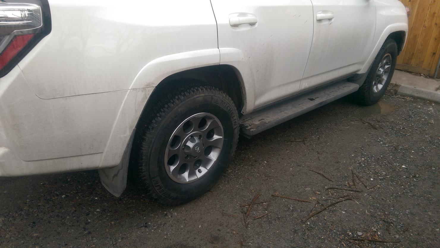

After consulting this, and numerous other threads I pulled the trigger on Michelin LTX A/T2s (stock size) in January. Came down to them and the Coopers but a combination of price and prior positive experiences with Michelins made the difference. Positive comments on the tire from 1engineer didn't hurt either! An oil services company had just picked up a new fleet of trucks and immediately replaced the stock Michelins with an LT tire, hence the great price.
I use the truck as a daily driver, but find myself on some light trails for fishing and camping purposes regularly. The Michelins (and the Coopers) seemed to be a solid compromise for my uses. The Coopers definitely look better, but I am actually quite pleased with the look of the Michelins - a little bit more AT looking than I initially thought they would. I've also always been a sucker for the Toyota 8-hole wheel and picked up a set for a reasonable price in the fall.
Any ways, just wanted to send out a general "thanks" to everyone who posted their experiences on here that helped me with the decision!
Happy to take better pictures later for anyone who wants a better look at the tires.
