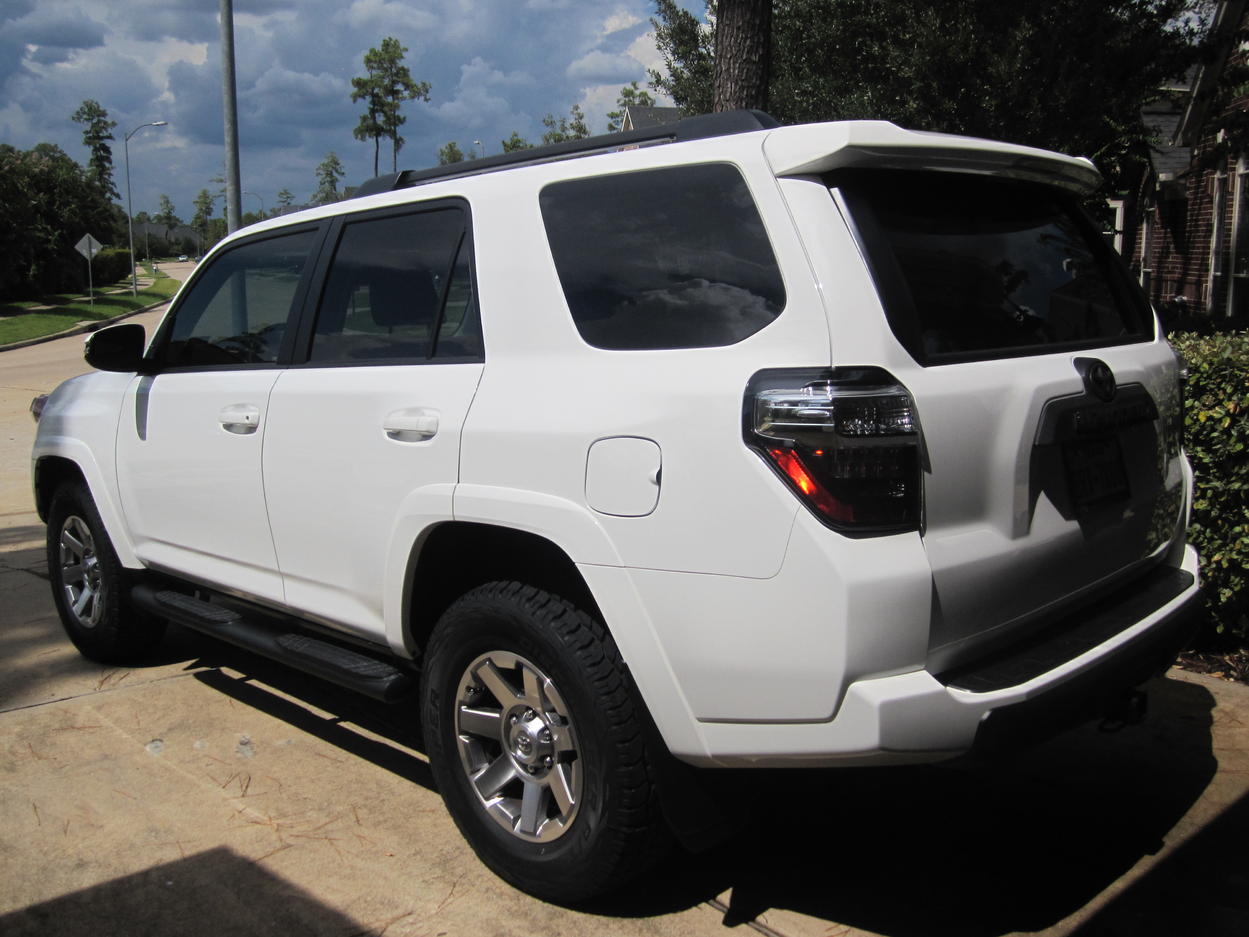

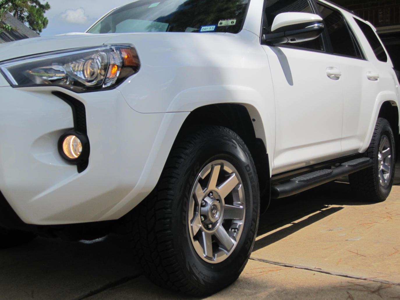

I mounted stock size Cooper AT3s on some 6 Shooters yesterday. I am experiencing the shakes at 80 km/hr. I was wondering if someone could give me some insights before I go back to the dealership. The tech who mounted the tires also has FN Wheels that's why I chose them. I bought the tires through a third party, so I'm kind worried about the warranty hassles.
They look nice mounted though!

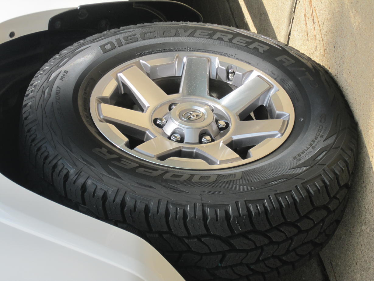

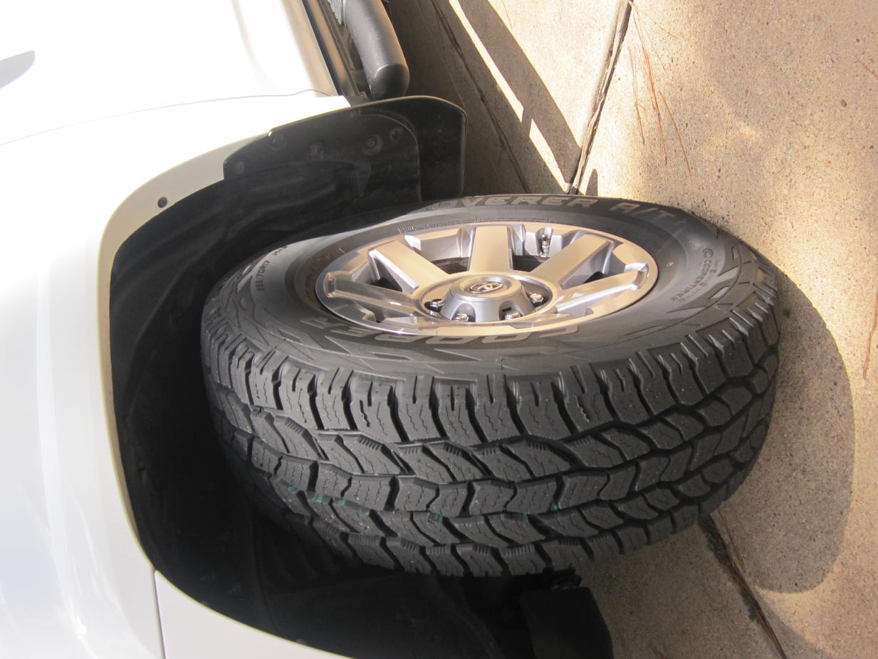

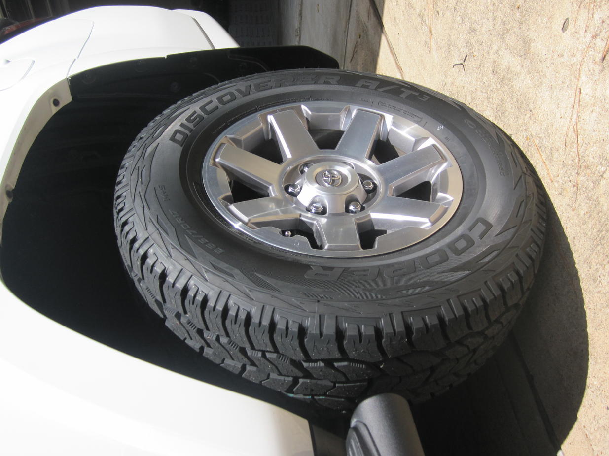

Just replaced my factory Dueler H/T shoes with about 5k on them with some new AT3's in stock 265/70/17 P-Rated and I can already tell a difference in their ability. Ride is just as quiet and comfortable as before, feels more secure and attached to the road, more responsive, less squishy feel and way better in the rain. I haven't had any vibration issues as of yet.
I had my local Discount Tire order them from DT Direct and then sold the Duelers on Craigslist. I have the blackside out and for me that works best. My 4R is my DD and at about 100 miles a day, but I wanted to still have a tire that I could easily take off road whenever the opportunity presents itself.
I'll let ya know how they continue to play out but I am fairly optimistic at the moment and would recommend to anyone on the fence about these tires. Even for stock size the look more stout on the truck.
