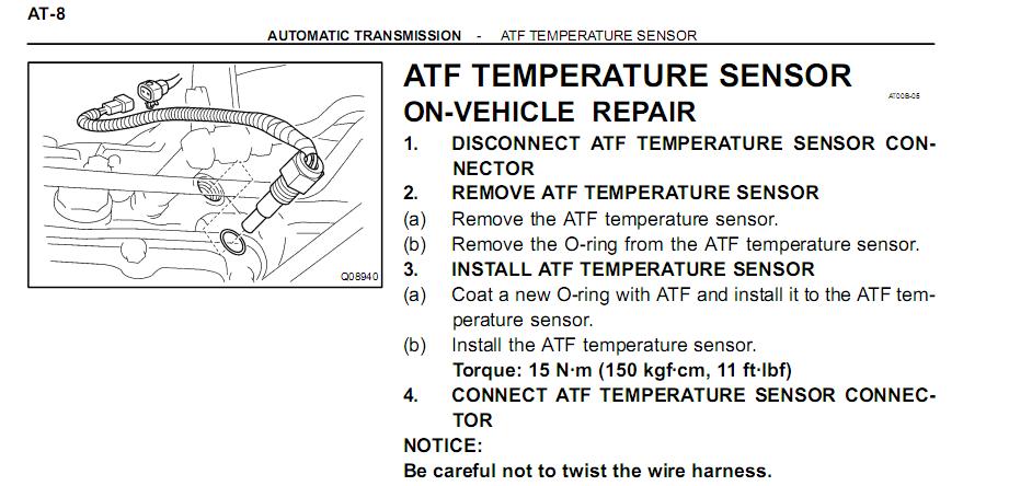

Hello there im new to this board i live in Suriname (south america) i recently bought a 96 2wd sr5(has limited badges) "bought it that way" and i have a problem i have a check engine light and pulled the code p0710 "Transmission Fluid Temperature Sensor Circuit Malfunction" i searched under the car but cannot locate the sensor does anybody have a good pic of where it should be i already looked in the service manual but its not where the manual says it should be the previous owner told me that he had changed the tranny a couple of months ago so could it be that this tranny doesnt have the temp sensor?

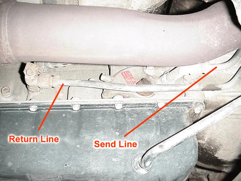

Here's two pics to help you find it.
In the live photo, the sensor is just behind the send line.

Thanks for the quick reply i already had the illustration out of the service manual and in the other pic where is the temp sensor? cause i dont see it my tranny looks the same but no sensor behind the send line if i look at the drawing where it should be i dont have a sensor there on my tranny

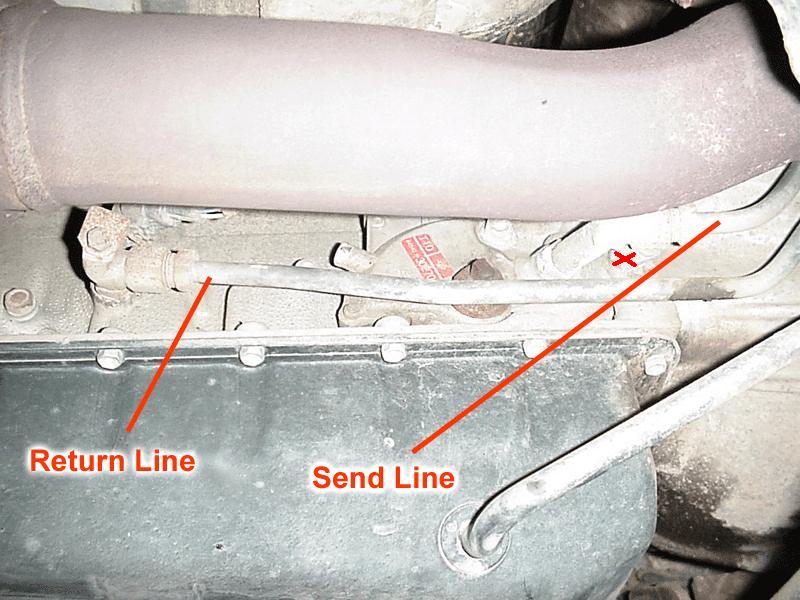

X marks the spot...

ok thanx alot but unfortunatly my tranny does not have it could it be a tranny from a older 4runner? i have the v6
Is there a hole there with a plug? Whoever replaced the tranny must have left it out. I don't know how you're going to get rid of the CEL unless you put a sensor in there.

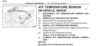

does anyone have pics for a 90 model runner? iv changed thermo and installed atf temp sensor today with no luck in getting od to work. im preety sure it is in the right place because mine looks much like the pic u guys posted BUT after the instalation, still no od, and the speedo misterously stopped working.... any suggestions?
there is another sensor in the converter or whatever .... behind the what i think to be the atf temp sens. what is that?
