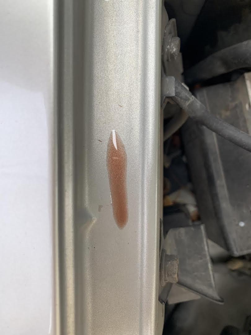

Hey guys,
Should I change the ATF? I'm not sure when it was last changed. The photo listed at the bottom is the condition of the fluid as of now:

looks good, as long as your trans isnt shifting hard, making weird noises , or low on ATF. if it is, then change the ATF. id likely change it in a few thousand miles just to have it on record and to give you a baseline for when you need to change it next. its a cheap and easy process, doesnt take too long to do.
I would be hesitant if the fluid smells burnt. Kinda hesitant cause I lost an Acura trans after I did a drain and flush, it lasted another 30k miles before it was undriveable. I was talking with a friend who works on trans for a living and told him my experience with my Acura. He said it all depends on how the fluid looks and smells.

thats crazy bro. from my experience, you typically dont want to change it out if the fluid is really dirty since the dirty fluid has more friction which is usually the only thing keeping the trans from slipping or not going into gear at all. if the fluid has still mostly retained its original color, you should be able to change it with no problems but then again im no trans expert lol

That's an old wives tale that hasn't been proven to be true at all. If your fluid is that dirty with loose friction material then your transmission is already on the way out because there is less friction material remaining on the clutches
I agree with bad luck. Mostly those extreme dirty fluid transmissions are on their last leg with major damage. So the damage is already done to it.
Exchange the fluid out clean the magnets and replace the filter. This way the fluid is lubricating your transmission again instead of sand blasting it as all the debris are in the fluid . Exchanging the fluid is always the best thing to do at regular intervals.

It was likely on its last legs, according to a former Acura tech I know those transmissions have a change interval of somewhere around 30k miles and don’t hold very much fluid, like 4 quarts.
I did a fluid change on a TSX at around 200k and the fluid was black and very burnt, still going strong at near 300k

That fluid looks like it has been regularly changed, though not brand new. No worries on continuing a normal drain+fill schedule.

I plan to flush the tranny using a method on YouTube. Now I gotta decide if I want to change the filter as well. I will check the fluid again and smell if it smells burnt - but to my knowledge, I didn't smell anything bad. Just smelled like regular transmission fluid.
I would drop the pan and replace the filter (get an OEM one, some of the aftermarket filters are junk). I'm seeing more and more transmission issues popping up on here because of plugged filters, it's cheap insurance.
The fluid looks like it's been changed before so that's good.
