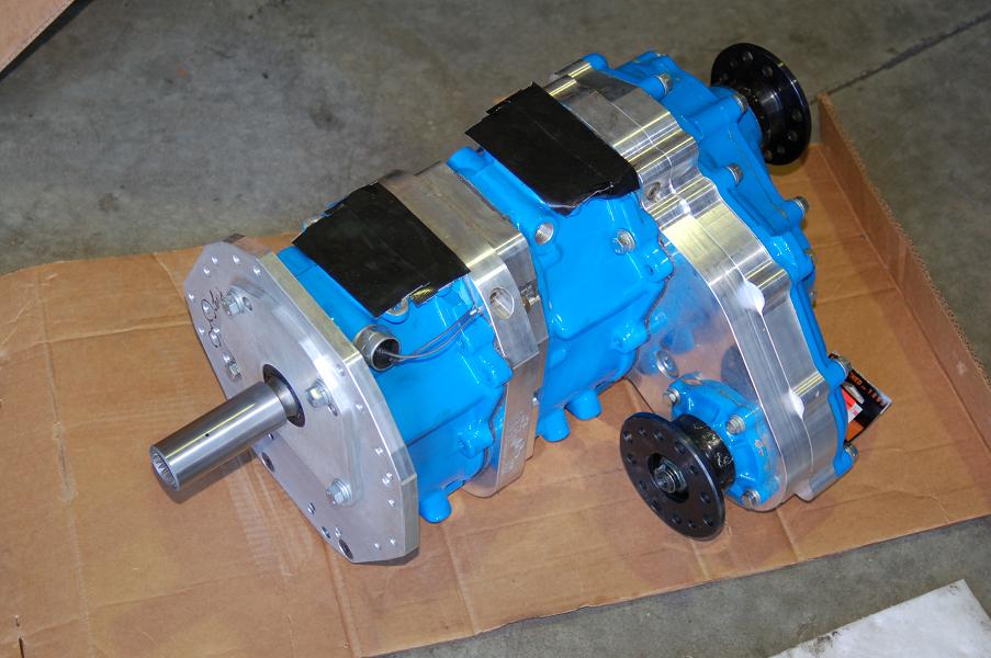

Marlin Crawler Lefty Tacoma FJ Cruiser Tundra Transfer Case Setup
Left-hand Front Output (Lefty)
Marlin Crawler is proud to offer the Inchworm Lefty, a left hand drop geared transfer case. We are now a full Tacoma, FJ Cruiser, and Tundra Rock Crawling drivetrain service shop. Our website will soon feature complete drivetrain options for your 1995 and newer Tacoma, FJ Cruiser, or Tundra, 4WD or Prerunner, automatic or manual transmission, 4-, 6-, or 8-cylinder applications. Full installation now available.
$2,589.00
