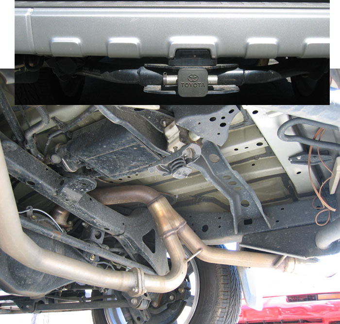

I would like pics of the dual exhaust with Xreas...I have the TRD dual exh. and I dont see how the spare tire will fit..even with modification...there is simply NOT enough room with the spare tire in to fit the exhaust pipe between the tire and the frame

thanks, but I was kind of meaning an "under the back" shot...
like I said...my spare fits right up on the frame (going from left to right)...and the driver's side exhaust pipe goes along the frame as well...so no room for both :(
Does your driver's side exhaust hang lower? like under the tire/frame?
ok...the spare tire WILL NOT FIT! The tire hits the exhaust running over to the driver's side way before it is in place. There is no way that spare is fitting with that driver's side pipe in the way.
The spare wants to fit all the way up next to the frame behind the driver's side exaust runner...it will not fit above the pipe, the tire is too wide.
I've done lots of mods between the Supras and 4Runners I've had so I like to think I'm no dummy...am I just missing something obvious?
I've seen other 4Runners with the trailer hitch mounted higher (in the square cutout on the bumper)...mine seems to be a few inches lower than the silver bumper square cut out...think this might have something to do with the amount of space under there?

I have the TRD setup for years
You have to put the tire in over the pipe first and then crank it up into place and it will fit right in....Its a little more difficult than stock, but well worth it.
