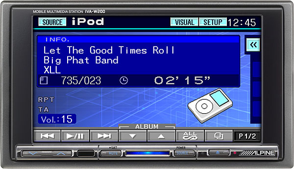

This is what I went with and its sick. Alpine IVA-W200...I can hook up everything but a grill to it..haha! I have a IPod cable that allows me to control my IPod from the touch screen on my head unit...wicked! Then it plays just about every format you can throw at it...and being a DVD player you can put alot music in Data format on the DVD and you will have a never ending supply of music. My Ipod is hidded in my glove box. I have it hooked up to factory speakers right now and its alright but I am installing an Infinity BassLink T and some Eclipse SA8364 speakers...just need to find all the "correct info" before I install them.
