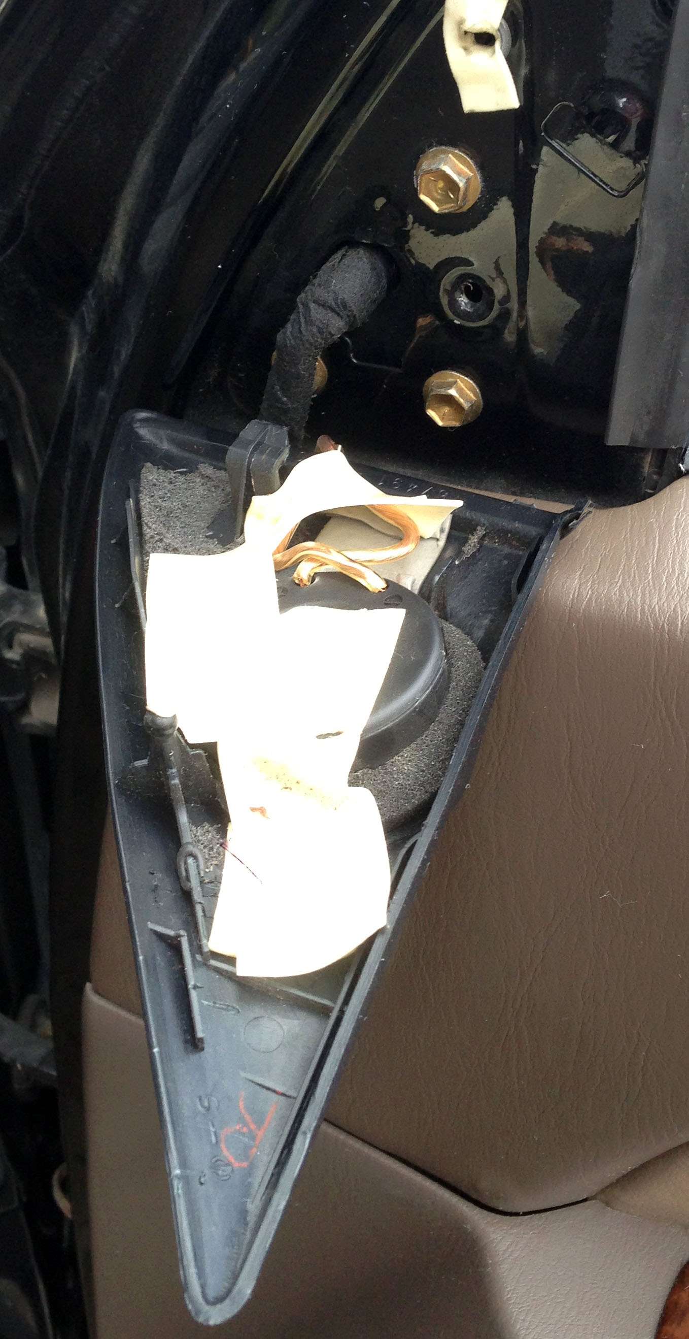

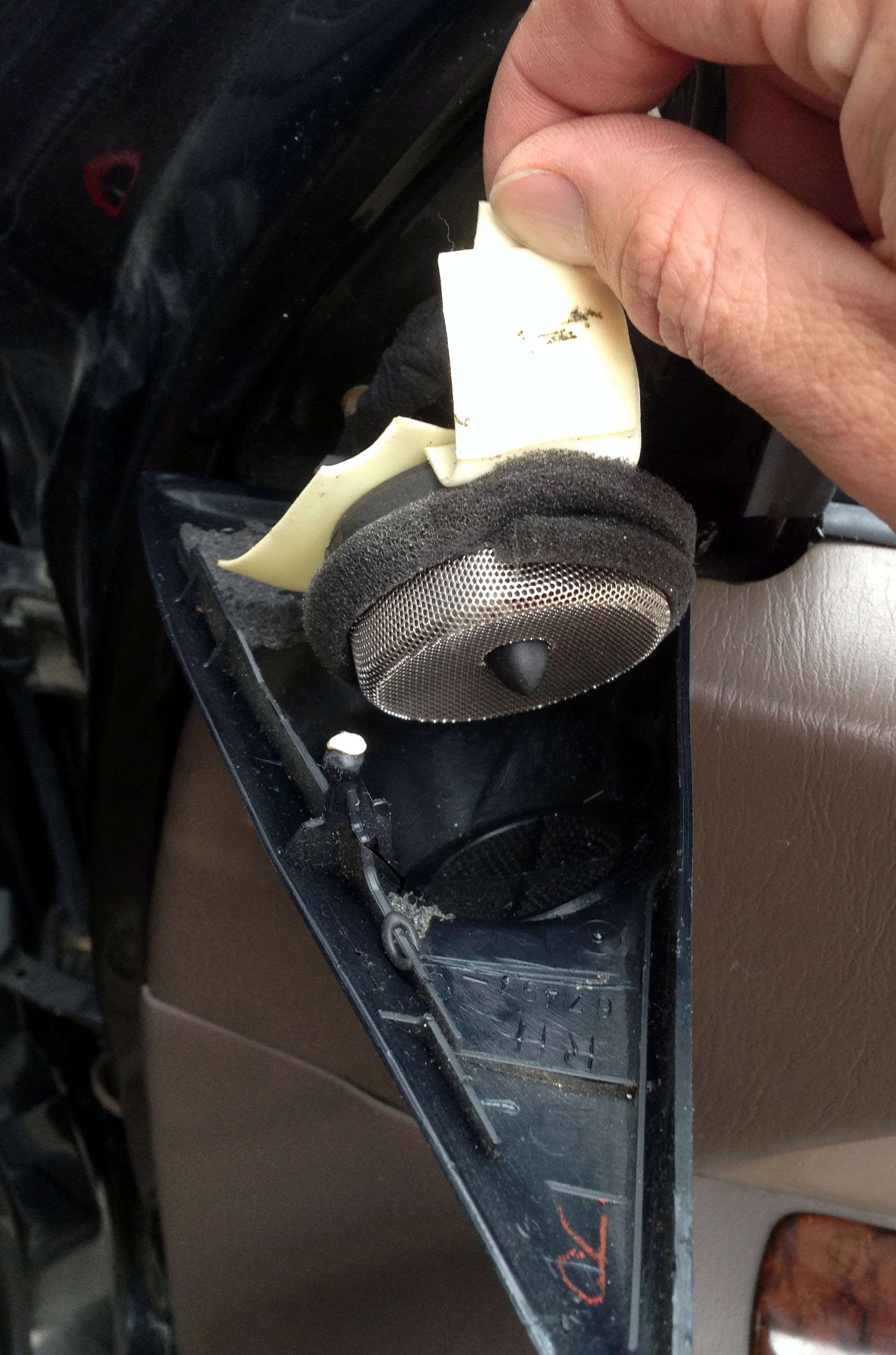

Speakers, Sound Deadening, and new wiring
Tweeter Install
