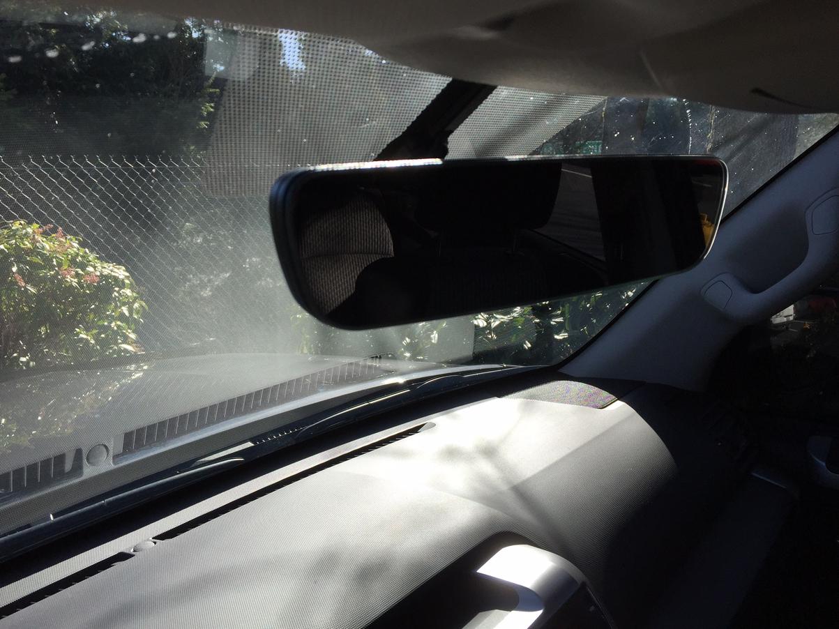

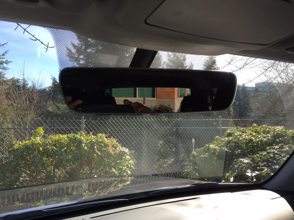

I purchased a 15' SR5 (NOT Premium) because I hate leather and dont have need or use of a sunroof since there is always something on the rack. Didn't realize the one premium option I assumed would be included would be a auto-dimming mirror, wrong. After having one for so many years its hard to go back to a standard mirror so here is how I made the upgrade, hope this helps someone.
I purchased a Gentex Infinity auto-dimming mirror with HomeLink and Compass off ebay. I wanted a nice brand new one!
This is my first write up so I'm sure it is somewhat incomplete. Let me know if you have any questions.

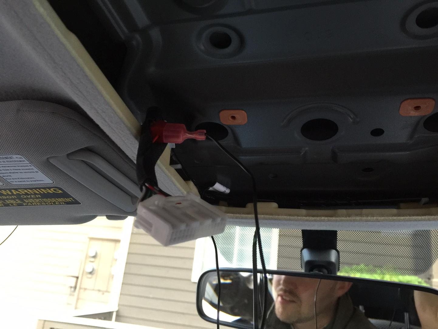

1. Remove the overhead console. Open the sunglasses holder to reveal (2) screws, unscrew these and the side of the console closest to the windshield should be loose enough to get your fingers in and pull down. The side of the console furthest away from the windshield is held in by 2 clips on either side. I pulled midway from the loose end (close to the windshield) and the middle of the console down to remove the console. It was a bit tight, might feel like youre going to break it but it came out nicely. This will expose the wiring harness, unclip this to completely remove.
In the wiring harness tied down near the drivers side visor is a constant power, I tapped into this for my constant. There is NO accessory power here.

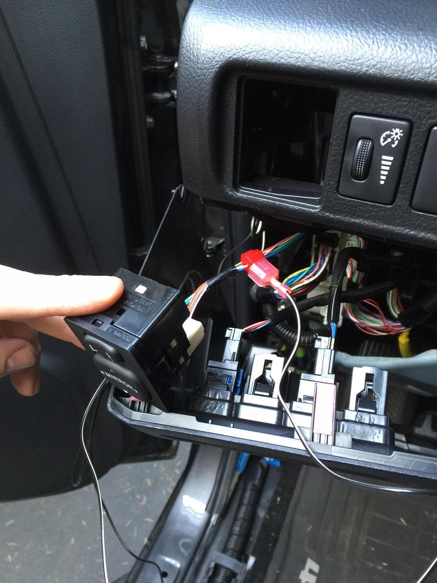

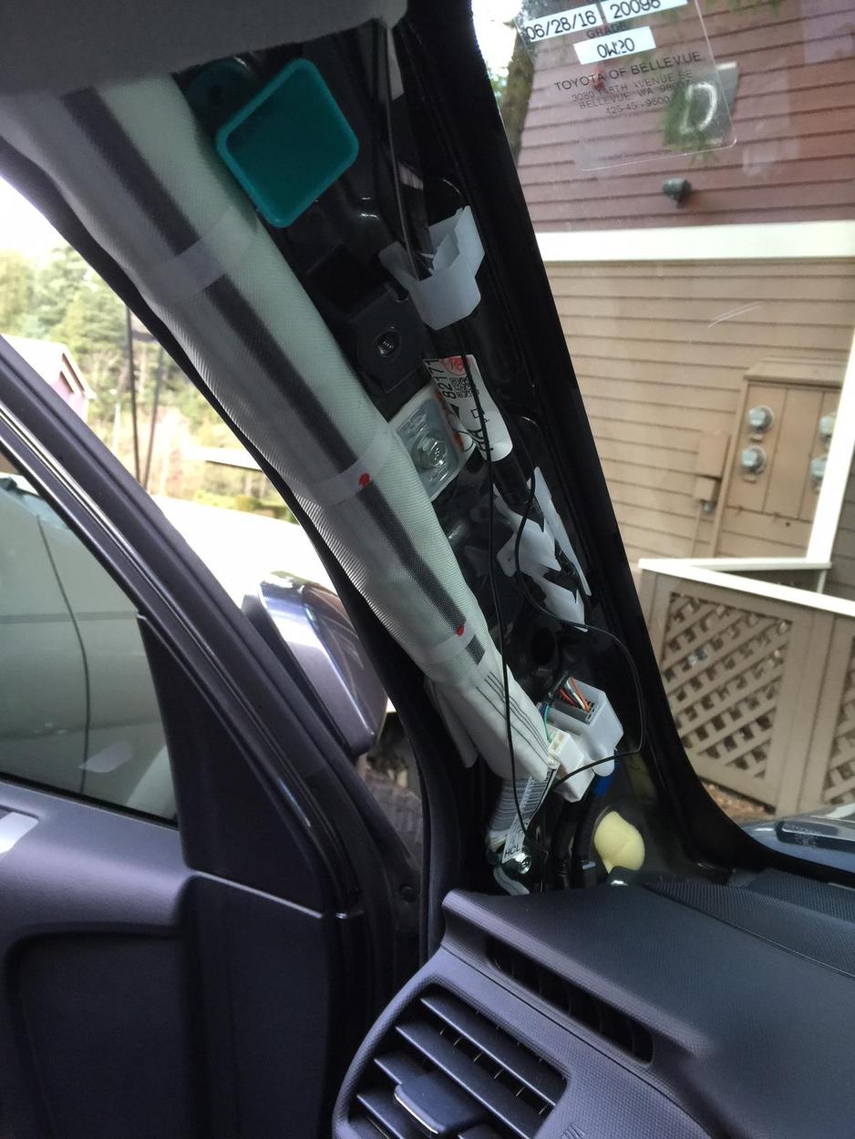

I found that the easiest place to tap into accessory power was running the accessory wire down the A pillar and tapping into the side power mirrors. Worked beautifully.

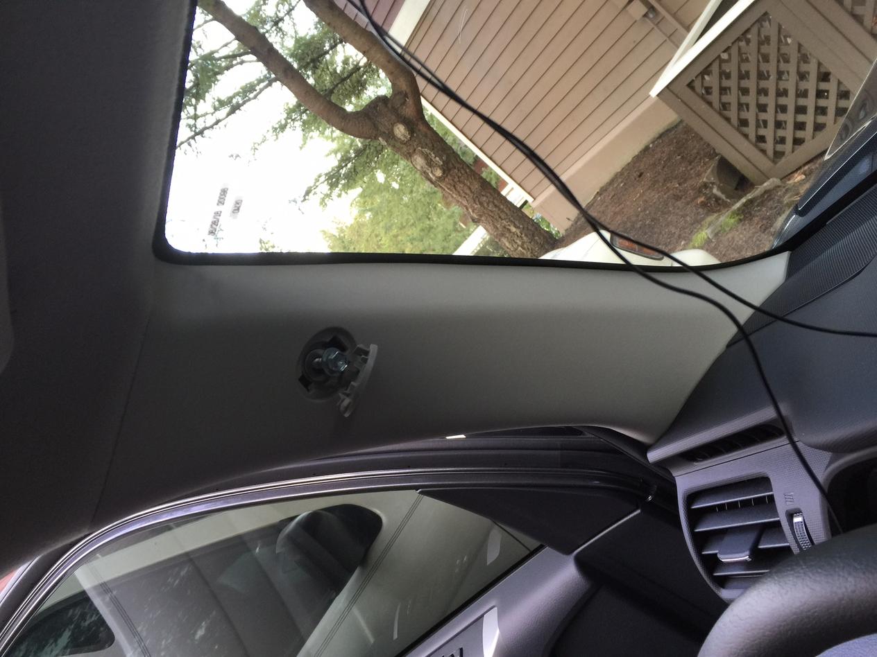

To remove the A Pillar, locate the circular air bag badge, gently pry it open FROM THE TOP of the badge to reveal a bolt, unscrew this. The only remaining clip is about 3/4 of the way down so pull this directly out and away.
I also had to partially remove the panel under the steering column, youll see the bolts on how to do this once your down there.
