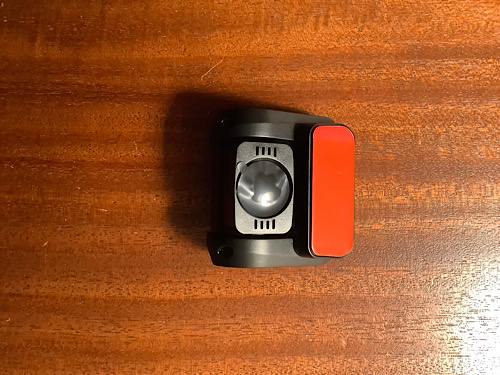

I am looking at that with maybe an L shape that I can stick the camera to. The tape is on the side of the lens. Red in photo

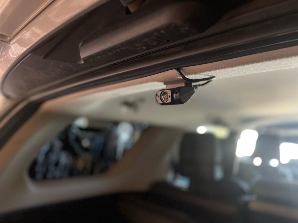

I cut up an aluminum sign , drilled a hole in it and mounted it to the headliner clip in the rear. the camera is just off set slightly to one side

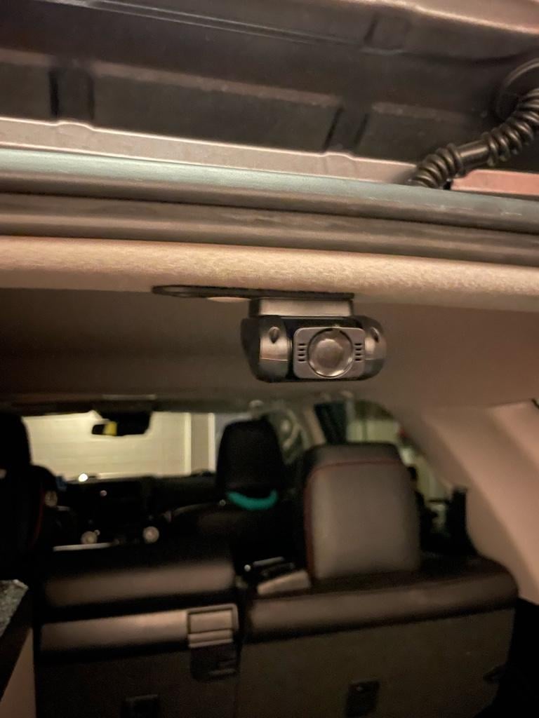

It’s just a flat piece of plastic I found with a hole in it. I took the plastic pin out and pushed it through the hole in the plastic. I think I will find a bolt to replace it though. It’s been fine off road and daily driving for about a year.

I have the exact camera set up in my ‘22. I cut up an old clear iPhone case for the ‘mounting plate’, drilled a small hole and attached it with the factory plastic headliner clip. It’s been holding for almost a year now with no issues.

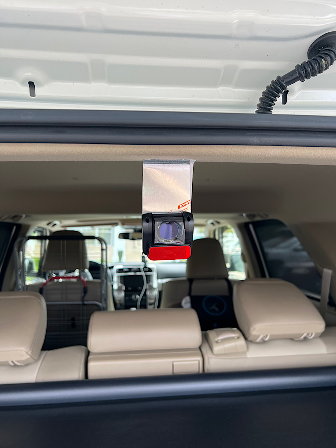

This is how I finally mounted the rear Viofo A129 Plus Duo rear cam. I have it down a ways so I can easily remove it by prying the headliner retaining pin out if needed. Also the cable plugs into the top of the cam, so you need a little room for it as well.
I bought a new retainer pin from a dealer ($2.96) to use. Glad I did as the one that came out was a bit stripped. It likely would have been ok to reuse but I felt more comfortable with new. The mount is from a thin metal sign I picked up in a hardware store that already had holes in it. Sign was easily cut with a large set of scissors, no tin snips needed.
The mount is thin enough that it could easily be bent back into the vehicle overhead if ever needed to load something large and then bent back into position.
