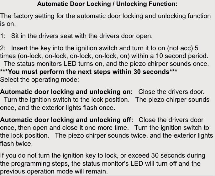

5VZ-FE Member Jan 30, 2022 #1 Anyone know if you can turn auto door locking on for a manual? I tried these instructions a few times before I realized that might be the issue. To be clear, this is supposed to be key turns to on, doors lock, key turns off they unlock. Not the one that depends on park/drive.
