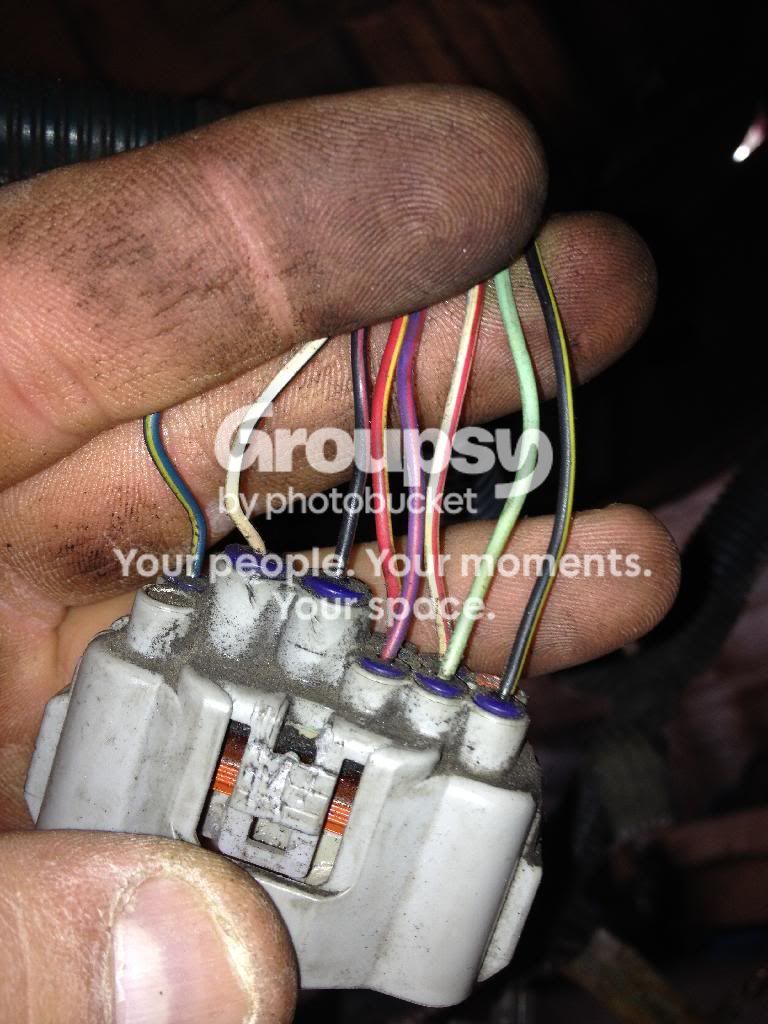

Here's my trans plug.
Looks like I have the following colors,
blue with a yellow stripe
white with a black stripe
black with a pink stripe
red with a yellow stripe
purple with a red stripe
white with a red stripe
green
black with a yellow stripe

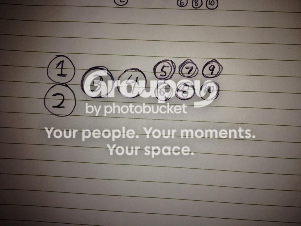

So here's a crude drawing of the layout of the plug, the numbers I have labeled the pin are for my reference.
So this is what i've gathered, correct me if the pin location is incorrect, I'm just trying to get an idea of what I need to do.

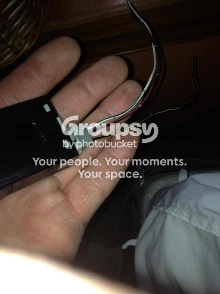

Dan in your picture it's hard to tell exactly which pin (referring to my drawing) that your white w/red wire and red w/yellow wire goes to.
Dan
1 blue w/yellow
2 not used
3 black w/white
4 black
5 white w/red
6 purple
7 red w/yellow
8 green
9 black w/red
10 black w/yellow
Jon & I
1 blue w/yellow
2 not used
3 white w/black
4 black w/red
5 red w/yellow
6 purple w/red
7 white w/red
8 green
9 not used
10 black w/yellow
So Dan, you said you did the following; (pin location refers to my drawing)
black to black w/white (pin 3 to pin 4) for clutch depress
black w/yellow to white w/red (pin 10 to pin 5) for clutch release
black w/yellow to red w/yellow (pin 10 to pin 7) for reverse switch
Therefore I would need to connect the following;
white w/black to black w/red (pin 3 to pin 4) for clutch depress
black w/yellow to red w/yellow (pin 10 to pin 5) for clutch release
black w/yellow to white w/red (pin 10 to pin 7) for reverse switch
I hope some of this makes sense?

Figured out the wiring! YAY!
White wire with the black stripe to the black wire with the red stripe (pin 3 to pin 4) for the clutch depress.
Black wire with the yellow stripe to the white wire with the red stripe (pin 10 to pin 7) for the clutch release.
Red wire with the yellow stripe to the black wire with the yellow stripe (pin 5 to pin 10) for the reverse switch.
Boom! Hope this helps someone out. This is on a 97 Limited model.
