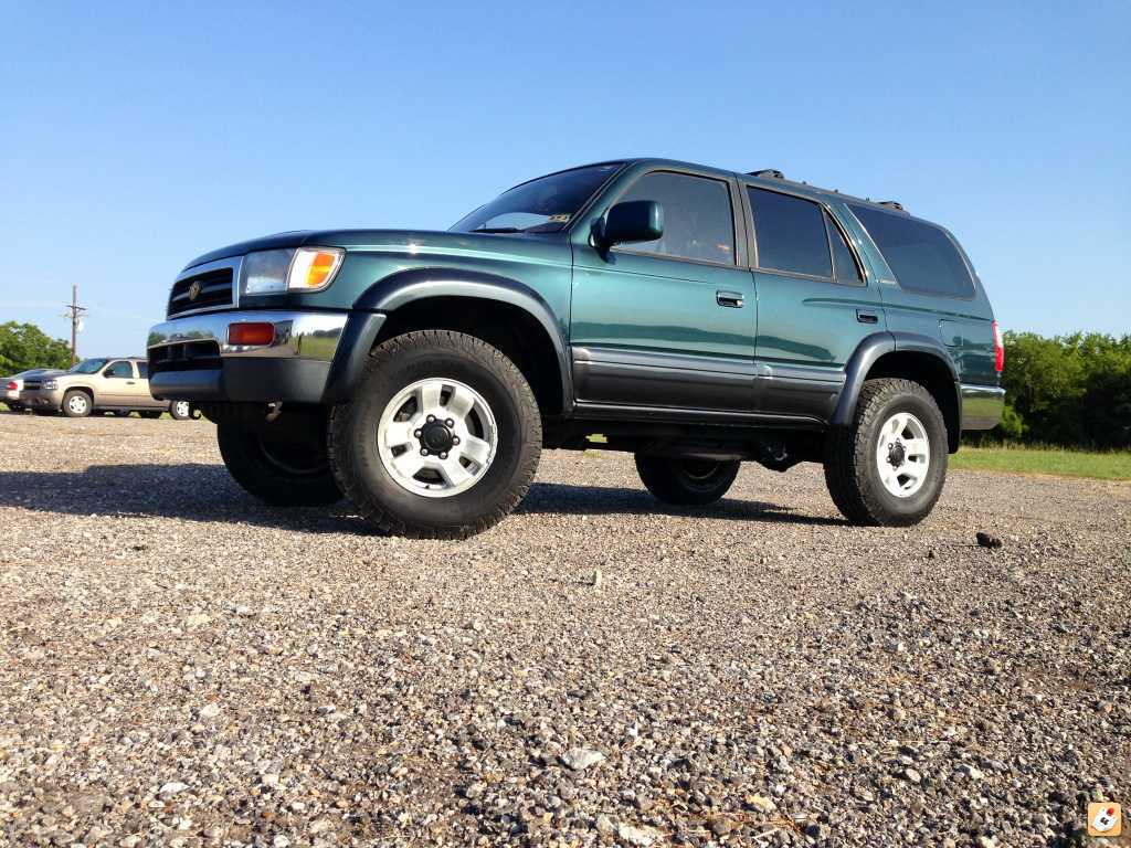

97 T4R Limited 4x4 w/ Automatic tranny. Is it possible to adjust the kick down point from OD lockup? I installed 265/75 tires the day I got the truck. Speedo is dead on with GPS all the way up to 75, haven't tested beyond there.
The problem is, When I am rolling along 65-70 with cruise one it kicks down on EVERY hill. I live near Dallas TX and the hills aren't that big. Seems like it is just out of adjustment or something. I don't mind if I drops 5mph going up the hill, I just get tired of the shifting. I used to be a motorcycle mechanic so I know my way around the toolbox but I have limited knowledge on vehicles.
