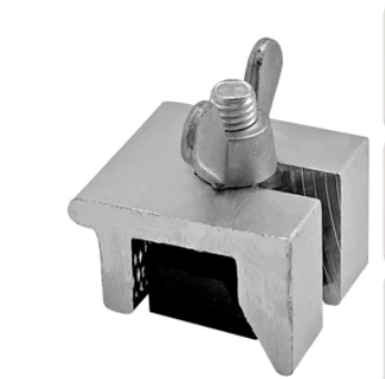

Anyways, when working on taking out the slack in the cable I used the below device to take out all of the slack and it completely reset the cable to be like new, it was about a 1 inch item. You can only adjust the nuts at the TB to remove a small amount of slack as you're just shifting the cable sheath to stick out further to remove slack. Adding this little device down by the pedal physically takes out all of the cable stretch. I highly recommend. Just make sure you completely remove the cable at the TB to give you more slack at the pedal to pull the cable down and clamp it on. It only took me 30 seconds and it was a night and day difference.
I have a picture of the exact one I used, but from the looks of all of the other versions I think they will all work. They're better than the items sold at the auto store as you don't have to cut the end off of the cable and it will fit any cable size.
It's a Window Slide Lock (in case you want to google). I hope the attachment is visible, I haven't used forums much since 2011.
