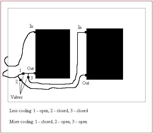

Please be sure to document this project here - as it might be something I do as well. :cheers:
I'm going to add a second one and plumb it so it's easy to bypass. Only have to mess with it twice a year, and it shouldn't take more than 10 minutes.
Actually more like 30 seconds to change. If you do it like this:
Thanks for the drawing franky.
I don't suppose you have any specific valves in mind for that job do you?
I was planning on doing what you drew....except instead of valves, just having two couplers, and having some loose hose ends to cap off when not in use. Basically install the second cooler, run both of the second cooler lines to that spot on the first cooler's "out" line, and simply unhook it and zip tie the lines out of the way when not in use.
But valves would be sweet...if they were a good design that didn't limit flow....

Some standard 3/8" full port ball valves would work. Something like this:
1786130601p
Ball Valve
Could be found at your local Lowe's, Home Depot, Ace Hardware, etc.
Or if you wanted to get real fancy you could use a three-way mixing valve in place of valves 1 & 3 in the above drawing.
3-Way Valve
The 3-way valve would have the same functionality as two separate valves, in that you could switch between using one cooler or both. Here comes the fun part - you could also set it to get partial flow to both ports. Then you'd have the cooling capacity of 1.5 coolers. (for the spring and fall when it's not or or cold outside)

Ha. The 3-way is a bit over kill I would think. Honestly, if I never towed anything, I'd be fine without even adding a 2nd cooler, although I am attracted to the two cooler idea for summer just to keep me average temps down. I like 150 (what I'm guessing I'll get with two coolers in play) alot more than 190 for constant in town driving....
