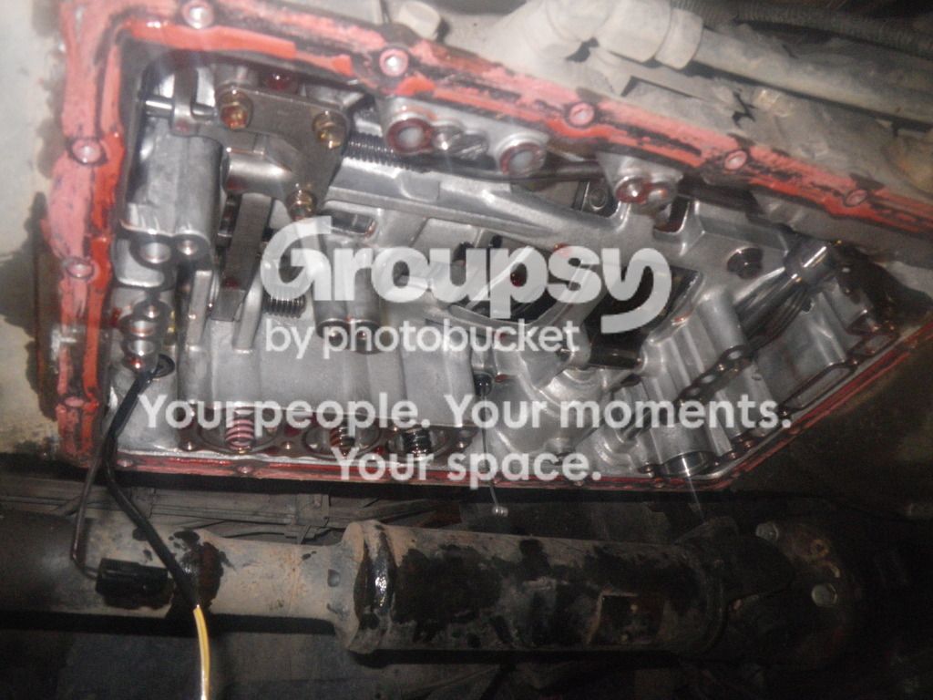

You can access all three solenoids by just dropping the filter. Here's an image i stole from the internets and circled solenoid e, and put arrows to the other two solenoids...
OP is right, there are no solenoids above the valve body. I just had my valve body out to install a shift kit. This is all there is above the valvebody.
no solenoids.
