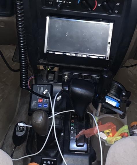

It’s been awhile, but I stand corrected. Both handles have 2 holes, but the 80/100 series handles are taller than the stock 3rd gen 4Runners. What I did was drill an extra hole on the top of the 80/100 series shifter. The picture below shows what I did. I did this back in 2016, I think. I also didn’t mess with the top spring to make it work
