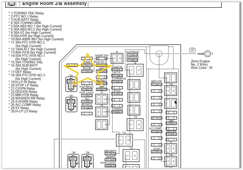

There are two paths; one full-time and one via key == acc & on- I'd try cleaning the contacts of fuse 'ecu-b'.
Here are the wiring diagrams<--
I'm looking for fuse ECU-B...

Look at the engine compartment fuse/relay box. Big black box next to your master cylinder.

icu-b fuse is in the engine bay box.
Thank you for the diagram. I'll check it out when I get home in another hour or so. I'm hoping I have some time to check this out...it really seems like it's a fuse the way it's acting... I certainly hope it's not something more complicated like a faulty switch. Intermittent stuff is so time consuming to track down without more access to the connectors and knowledge of where all the wires are.
