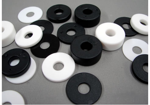

You could use a nylon spacer. They come in white or black and can be found at any hardware store at different thicknesses.
Or you could use a riser pad from a skateboard and cut it to size if you want something square instead
I'm thinking of trying something like these square washers. I know washers would be an easy fix but worry a little about the stability of round washers. I'm also going to look around for some rubber that maybe I can trim to fit. Is there anywhere local I could look to find skateboard riser pads? That looks like it could work.
The riser pads can be found at you local skate shop; should be able to google or yellowpages that one. They usually have different thicknesses of those, but pay attention to the material because the cheep-o's are soft foam and the rest are usually a hard plastic. Some have designs cut out of the middle too, so try to find a generic looking one like I posted so that there's more material to work with.
